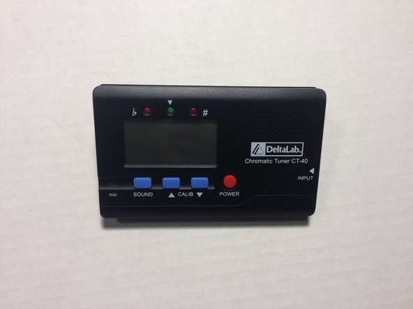

DeltaLab CT-40 Chromatic Tuner Input Jack Port Replacement
  1. DeltaLab CT-40 Chromatic Tuner Input Jack Port Replacement, Input Jack Port: crwdns2935265:01crwdnd2935265:01crwdnd2935265:02crwdne2935265:0 DeltaLab CT-40 Chromatic Tuner Input Jack Port Replacement, Input Jack Port: crwdns2935265:01crwdnd2935265:02crwdnd2935265:02crwdne2935265:0

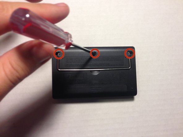

    • First, open the metal stand to access the screws without damaging the body.
  2. DeltaLab CT-40 Chromatic Tuner Input Jack Port Replacement: crwdns2935265:02crwdnd2935265:01crwdnd2935265:02crwdne2935265:0 DeltaLab CT-40 Chromatic Tuner Input Jack Port Replacement: crwdns2935265:02crwdnd2935265:02crwdnd2935265:02crwdne2935265:0
    • Remove the 3 outer 1.2 mm Phillips #1 screws using a small head screwdriver.
  3. DeltaLab CT-40 Chromatic Tuner Input Jack Port Replacement: crwdns2935265:03crwdnd2935265:01crwdnd2935265:02crwdne2935265:0 DeltaLab CT-40 Chromatic Tuner Input Jack Port Replacement: crwdns2935265:03crwdnd2935265:02crwdnd2935265:02crwdne2935265:0
    • Remove the back casing to reveal the inner circuitry.
