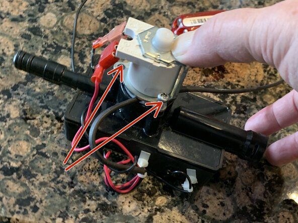

    • Remove the three Phillips screws at the base of the metal retainer.
    • Gently lift the assembly from the base to expose the valve. That little silver cylinder is the valve. There is a spring under it, so it wants to pop out. (Red arrow)
