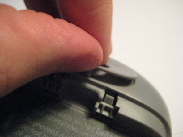

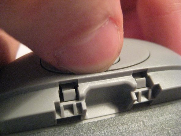

    • Locate the large button on the top of the device.
    • Push down on the button and slide the cover away from the button.
    • The battery removal tab may pop up.

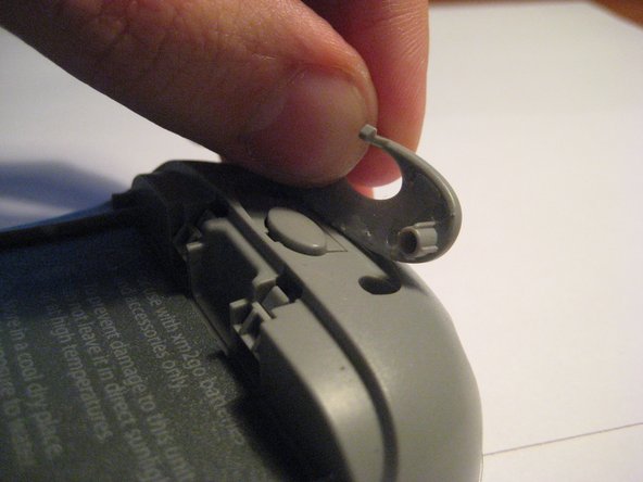

  4. Delphi MyFi XM2GO Motherboard Replacement: crwdns2935265:04crwdnd2935265:01crwdnd2935265:03crwdne2935265:0 Delphi MyFi XM2GO Motherboard Replacement: crwdns2935265:04crwdnd2935265:02crwdnd2935265:03crwdne2935265:0 Delphi MyFi XM2GO Motherboard Replacement: crwdns2935265:04crwdnd2935265:03crwdnd2935265:03crwdne2935265:0
    • Remove the button cover on the back of the device by prying it up with a spudger or your thumb nail.

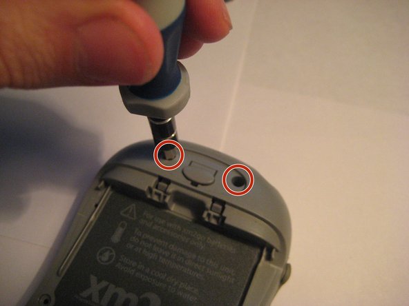

  5. Delphi MyFi XM2GO Motherboard Replacement: crwdns2935265:05crwdnd2935265:01crwdnd2935265:03crwdne2935265:0 Delphi MyFi XM2GO Motherboard Replacement: crwdns2935265:05crwdnd2935265:02crwdnd2935265:03crwdne2935265:0 Delphi MyFi XM2GO Motherboard Replacement: crwdns2935265:05crwdnd2935265:03crwdnd2935265:03crwdne2935265:0
    • Remove the two screws under the button using the T6 Torx screwdriver.

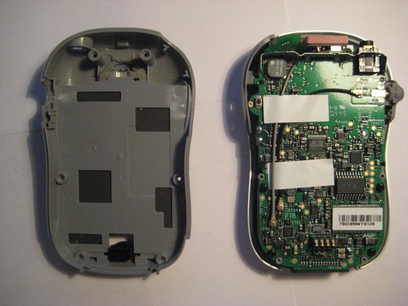

  6. Delphi MyFi XM2GO Motherboard Replacement: crwdns2935265:06crwdnd2935265:01crwdnd2935265:02crwdne2935265:0 Delphi MyFi XM2GO Motherboard Replacement: crwdns2935265:06crwdnd2935265:02crwdnd2935265:02crwdne2935265:0
    • Remove the back cover.

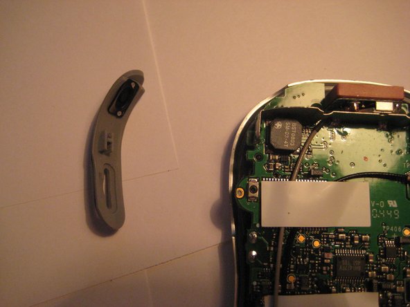

  7. Delphi MyFi XM2GO Motherboard Replacement: crwdns2935265:07crwdnd2935265:01crwdnd2935265:02crwdne2935265:0 Delphi MyFi XM2GO Motherboard Replacement: crwdns2935265:07crwdnd2935265:02crwdnd2935265:02crwdne2935265:0
    • Remove the power button by pulling it to the left.

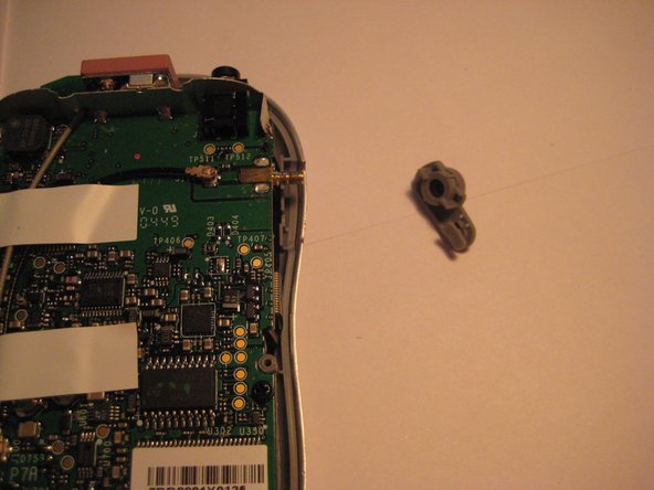

  8. Delphi MyFi XM2GO Motherboard Replacement: crwdns2935265:08crwdnd2935265:01crwdnd2935265:02crwdne2935265:0 Delphi MyFi XM2GO Motherboard Replacement: crwdns2935265:08crwdnd2935265:02crwdnd2935265:02crwdne2935265:0
    • Remove the plastic antenna extension connector on the right side of the device.

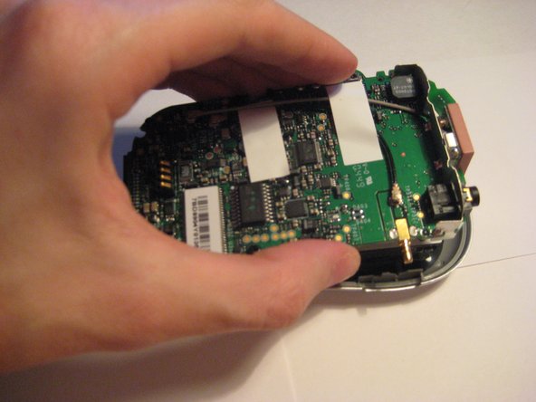

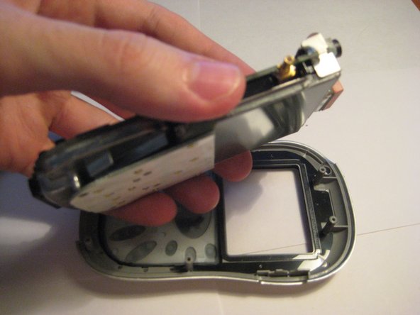

  9. Delphi MyFi XM2GO Motherboard Replacement: crwdns2935265:09crwdnd2935265:01crwdnd2935265:03crwdne2935265:0 Delphi MyFi XM2GO Motherboard Replacement: crwdns2935265:09crwdnd2935265:02crwdnd2935265:03crwdne2935265:0 Delphi MyFi XM2GO Motherboard Replacement: crwdns2935265:09crwdnd2935265:03crwdnd2935265:03crwdne2935265:0
    • Pull up on the motherboard to remove it from the device.
    • The LCD screen and keypad are only connected to the motherboard with ribbon cables. They will hang down as the motherboard is removed.
