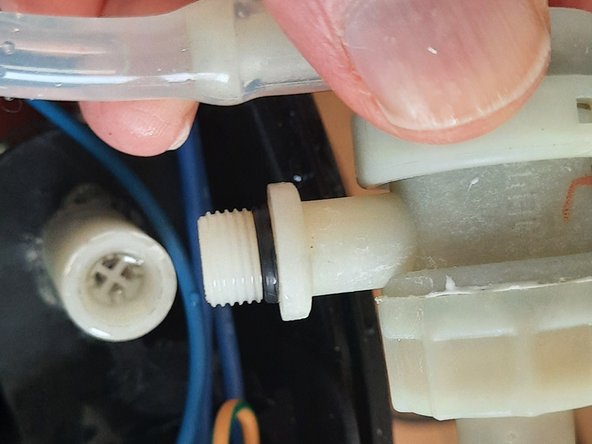

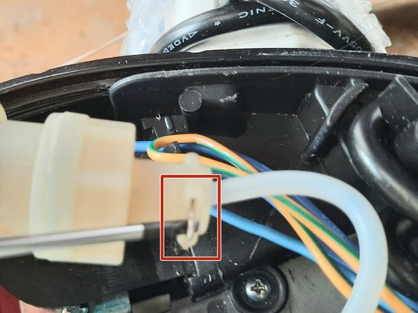

  7. Delonghi EC220.CD coffee machine Pump Replacement, Remove the plastic 3-way (OPV) valve: crwdns2935265:07crwdnd2935265:01crwdnd2935265:03crwdne2935265:0 Delonghi EC220.CD coffee machine Pump Replacement, Remove the plastic 3-way (OPV) valve: crwdns2935265:07crwdnd2935265:02crwdnd2935265:03crwdne2935265:0 Delonghi EC220.CD coffee machine Pump Replacement, Remove the plastic 3-way (OPV) valve: crwdns2935265:07crwdnd2935265:03crwdnd2935265:03crwdne2935265:0
    • Pull the clear tube out of the top of the coffee maker.
    • Locate the white plastic 3-way valve at the rear top of the machine. This is the Over Pressure Valve, and controls the pressure of the water flowing into the boiler through a simple spring mechanism. The excess water is returned to the reservoir via the clear plastic tube.
    • Pull the clip out of the valve that attaches a small tube to the boiler. You'll see that the clip traps a brass collar around the tube into the valve. Pull the tube clear.
    • Rotate the valve anti-clockwise to unscrew it from the pump. It can be a bit difficult to move.
