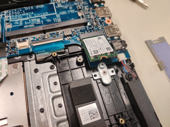

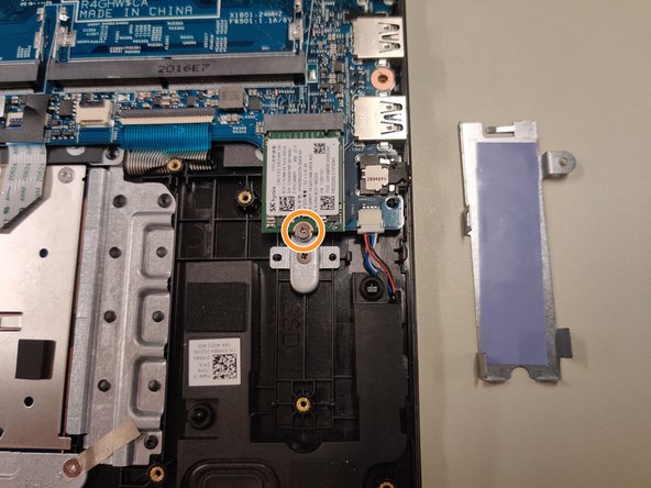

  4. Dell latitude 3500 Teardown, Remove M.2 SSD: crwdns2935265:04crwdnd2935265:01crwdnd2935265:03crwdne2935265:0 Dell latitude 3500 Teardown, Remove M.2 SSD: crwdns2935265:04crwdnd2935265:02crwdnd2935265:03crwdne2935265:0 Dell latitude 3500 Teardown, Remove M.2 SSD: crwdns2935265:04crwdnd2935265:03crwdnd2935265:03crwdne2935265:0
    • One screw holds an aluminum plate in place over the SSD to disperse heat.
    • Another screw holds the actual SSD in place.

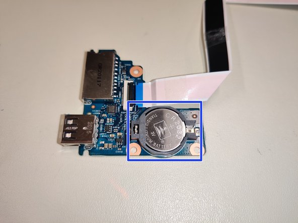

  5. Dell latitude 3500 Teardown, Remove USB/SD Card Reader: crwdns2935265:05crwdnd2935265:01crwdnd2935265:03crwdne2935265:0 Dell latitude 3500 Teardown, Remove USB/SD Card Reader: crwdns2935265:05crwdnd2935265:02crwdnd2935265:03crwdne2935265:0 Dell latitude 3500 Teardown, Remove USB/SD Card Reader: crwdns2935265:05crwdnd2935265:03crwdnd2935265:03crwdne2935265:0
    • 2 screws
    • Carefully lift the black tab to free the ribbon cable from it's connection to the motherboard.
    • On the underside is where the CMOS battery is located.

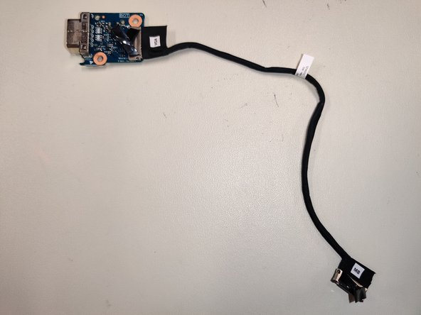

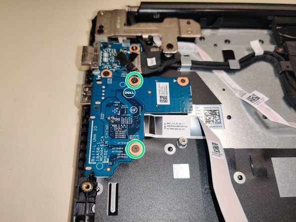

  7. Dell latitude 3500 Teardown, Remove VGA Board: crwdns2935265:07crwdnd2935265:01crwdnd2935265:02crwdne2935265:0 Dell latitude 3500 Teardown, Remove VGA Board: crwdns2935265:07crwdnd2935265:02crwdnd2935265:02crwdne2935265:0
    • 2 screws total
    • the cable can be unplugged from the motherboard by carefully pulling up on the connector

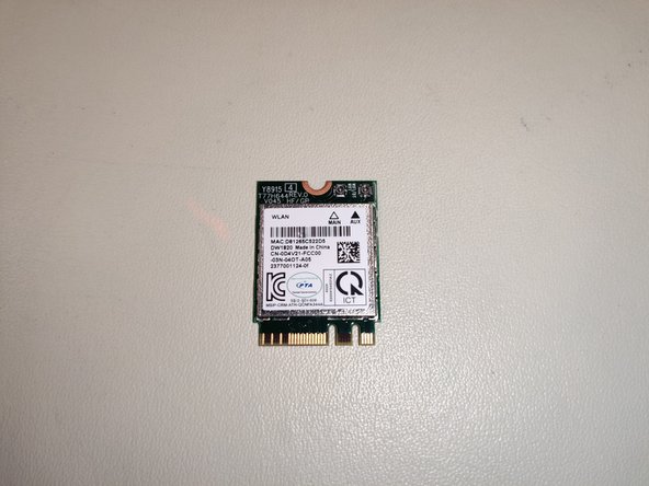

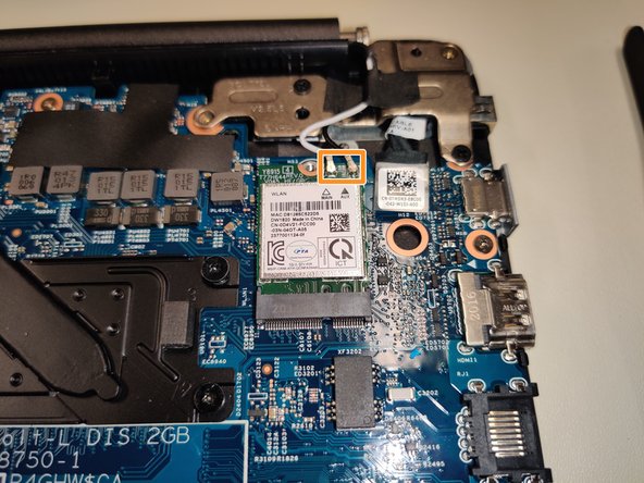

  8. Dell latitude 3500 Teardown, Remove Wi-Fi Card: crwdns2935265:08crwdnd2935265:01crwdnd2935265:03crwdne2935265:0 Dell latitude 3500 Teardown, Remove Wi-Fi Card: crwdns2935265:08crwdnd2935265:02crwdnd2935265:03crwdne2935265:0 Dell latitude 3500 Teardown, Remove Wi-Fi Card: crwdns2935265:08crwdnd2935265:03crwdnd2935265:03crwdne2935265:0
    • 1 screw total, holds a small bracket in place over the antennas.
    • Use a tool to carefully lift the antennas upwards from their connections.

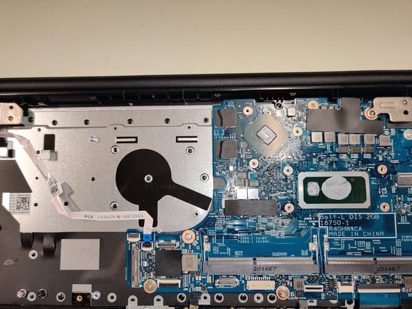

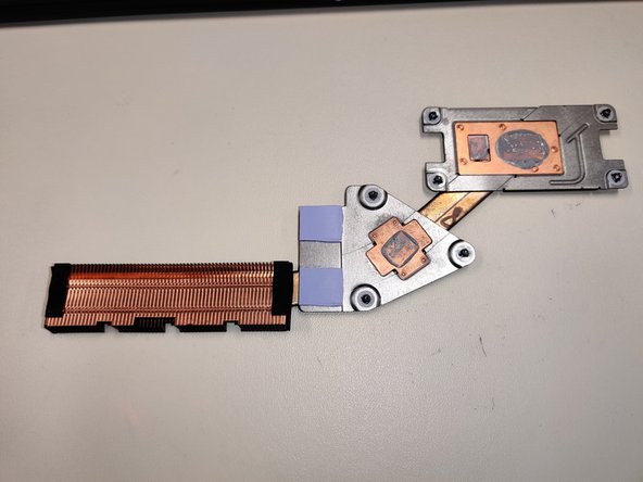

  10. Dell latitude 3500 Teardown, Remove CPU Heatsink: crwdns2935265:010crwdnd2935265:01crwdnd2935265:03crwdne2935265:0 Dell latitude 3500 Teardown, Remove CPU Heatsink: crwdns2935265:010crwdnd2935265:02crwdnd2935265:03crwdne2935265:0 Dell latitude 3500 Teardown, Remove CPU Heatsink: crwdns2935265:010crwdnd2935265:03crwdnd2935265:03crwdne2935265:0
    • 7 screws total
    • The screws are numbered to spread the thermal paste the most evenly across each die.

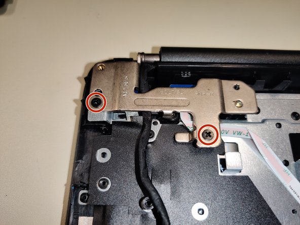

  11. Dell latitude 3500 Teardown, Lift Hinges: crwdns2935265:011crwdnd2935265:01crwdnd2935265:02crwdne2935265:0 Dell latitude 3500 Teardown, Lift Hinges: crwdns2935265:011crwdnd2935265:02crwdnd2935265:02crwdne2935265:0
    • 2 screws on each side
    • These hinges hold the 2 halves together, so it will slide when you lift them up

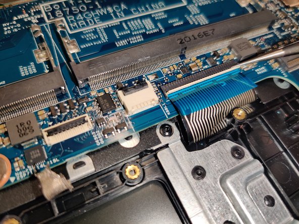

  12. Dell latitude 3500 Teardown, Disconnect Remaining Connections: crwdns2935265:012crwdnd2935265:01crwdnd2935265:01crwdne2935265:0
    • There should be three connectors still attached to the motherboard.

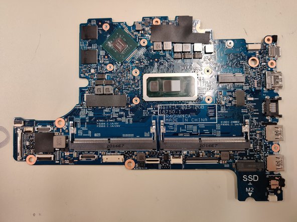

  13. Dell latitude 3500 Teardown, Remove Motherboard: crwdns2935265:013crwdnd2935265:01crwdnd2935265:03crwdne2935265:0 Dell latitude 3500 Teardown, Remove Motherboard: crwdns2935265:013crwdnd2935265:02crwdnd2935265:03crwdne2935265:0 Dell latitude 3500 Teardown, Remove Motherboard: crwdns2935265:013crwdnd2935265:03crwdnd2935265:03crwdne2935265:0
    • 4 screws total

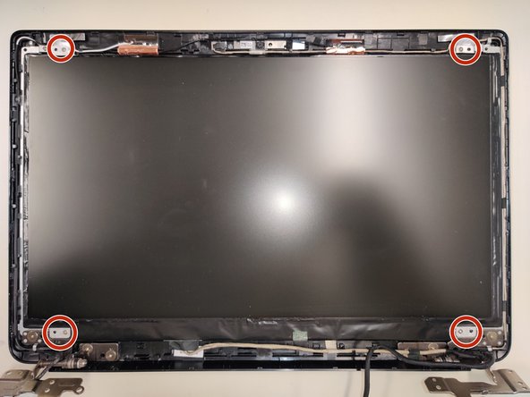

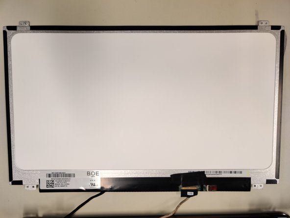

  14. Dell latitude 3500 Teardown, Remove Screen Cover: crwdns2935265:014crwdnd2935265:01crwdnd2935265:03crwdne2935265:0 Dell latitude 3500 Teardown, Remove Screen Cover: crwdns2935265:014crwdnd2935265:02crwdnd2935265:03crwdne2935265:0 Dell latitude 3500 Teardown, Remove Screen Cover: crwdns2935265:014crwdnd2935265:03crwdnd2935265:03crwdne2935265:0
    • Spudge around the edges, even the hinge.
    • Thin(but strong) adhesive is placed around the border of the screen.
    • 4 screws holding screen in place.
