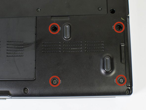

  4. Dell XPS M1530 Hard Drive Replacement, Hard Drive: crwdns2935265:04crwdnd2935265:01crwdnd2935265:02crwdne2935265:0 Dell XPS M1530 Hard Drive Replacement, Hard Drive: crwdns2935265:04crwdnd2935265:02crwdnd2935265:02crwdne2935265:0
    • Remove the four Phillips #1 screws holding the Hard Drive in place.
    • Four 3.5mm Phillips #1 screws
  5. Dell XPS M1530 Hard Drive Replacement: crwdns2935265:05crwdnd2935265:01crwdnd2935265:02crwdne2935265:0 Dell XPS M1530 Hard Drive Replacement: crwdns2935265:05crwdnd2935265:02crwdnd2935265:02crwdne2935265:0
    • Pull the Hard Drive out gently using the tab. It should provide enough leverage to pull the drive out smoothly.

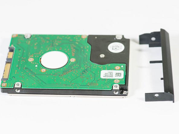

  6. Dell XPS M1530 Hard Drive Replacement: crwdns2935265:06crwdnd2935265:01crwdnd2935265:02crwdne2935265:0 Dell XPS M1530 Hard Drive Replacement: crwdns2935265:06crwdnd2935265:02crwdnd2935265:02crwdne2935265:0
    • Remove both 3.5mm Phillips #1 screws on either side of the plastic casing.
    • There is a second screw on the other side of the casing.
    • Then gently separate the drive from its casing.
