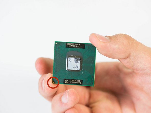

    1. Dell XPS M1530 CPU Replacement, CPU: crwdns2935265:010crwdnd2935265:01crwdnd2935265:01crwdne2935265:0
      • Use a Metal Spudger to turn the black plastic screw to the unlock position from the secure position of the CPU on the motherboard.
    2. Dell XPS M1530 CPU Replacement: crwdns2935265:011crwdnd2935265:01crwdnd2935265:03crwdne2935265:0 Dell XPS M1530 CPU Replacement: crwdns2935265:011crwdnd2935265:02crwdnd2935265:03crwdne2935265:0 Dell XPS M1530 CPU Replacement: crwdns2935265:011crwdnd2935265:03crwdnd2935265:03crwdne2935265:0

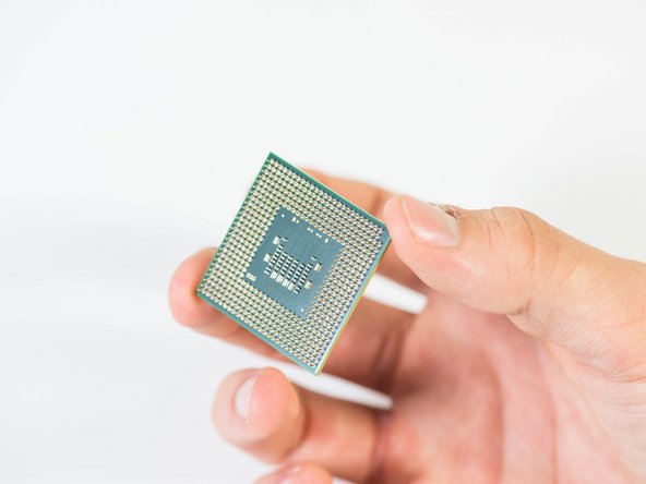

      • Carefully remove the CPU by pulling it straight up.
      • CPU Orientation triangle
      • Make sure you pull straight up on the CPU when removing it. Also be careful not to touch the pins on the CPU as they are thin and will bend very easily.
      • The orientation of the CPU is important, locate the corners that has a small triangle. Make sure to match that triangle corner to the upper right corner of the mount that also has a picture of a triangle.
