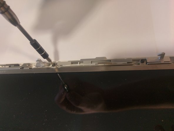

  4. Dell XPS M140 Screen Replacement: crwdns2935265:04crwdnd2935265:01crwdnd2935265:01crwdne2935265:0
    • Unscrew the screws on the casing that you just exposed.

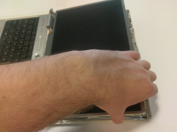

  5. Dell XPS M140 Screen Replacement: crwdns2935265:05crwdnd2935265:01crwdnd2935265:03crwdne2935265:0 Dell XPS M140 Screen Replacement: crwdns2935265:05crwdnd2935265:02crwdnd2935265:03crwdne2935265:0 Dell XPS M140 Screen Replacement: crwdns2935265:05crwdnd2935265:03crwdnd2935265:03crwdne2935265:0
    • With care, pop off the plastic clips sourrounding the casing.
    • Run your hand, or a tool, around the perimeter, to remove the casing.

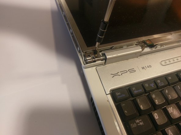

  6. Dell XPS M140 Screen Replacement: crwdns2935265:06crwdnd2935265:01crwdnd2935265:03crwdne2935265:0 Dell XPS M140 Screen Replacement: crwdns2935265:06crwdnd2935265:02crwdnd2935265:03crwdne2935265:0 Dell XPS M140 Screen Replacement: crwdns2935265:06crwdnd2935265:03crwdnd2935265:03crwdne2935265:0
    • Once the casing is removed, more screws should be exposed.
    • Remove every screw.

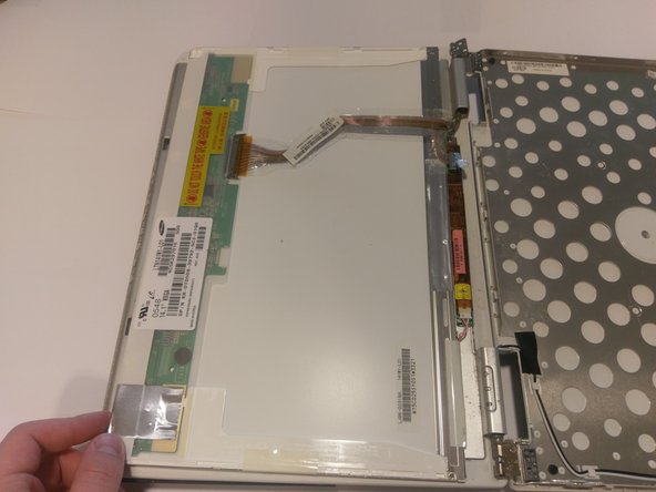

  7. Dell XPS M140 Screen Replacement: crwdns2935265:07crwdnd2935265:01crwdnd2935265:03crwdne2935265:0 Dell XPS M140 Screen Replacement: crwdns2935265:07crwdnd2935265:02crwdnd2935265:03crwdne2935265:0 Dell XPS M140 Screen Replacement: crwdns2935265:07crwdnd2935265:03crwdnd2935265:03crwdne2935265:0
    • Once all of the screws are removed, the screen should be loose.
    • Gently pick it up and place it face down onto the keyboard.
  8. Dell XPS M140 Screen Replacement: crwdns2935265:08crwdnd2935265:01crwdnd2935265:03crwdne2935265:0 Dell XPS M140 Screen Replacement: crwdns2935265:08crwdnd2935265:02crwdnd2935265:03crwdne2935265:0 Dell XPS M140 Screen Replacement: crwdns2935265:08crwdnd2935265:03crwdnd2935265:03crwdne2935265:0
    • There should be two connections.
    • One with a blue looking handle, and one with clips.
    • To remove the connection with the clips, squeeze the two clips together and pull the ribbon cable.
    • To remove the connection with the blue handle, gently pull on the blue handle, it should come right off.
