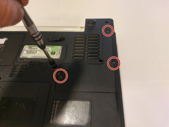

Dell XPS M140 CPU Heatsink Replacement
  1. Dell XPS M140 CPU Heatsink Replacement, Battery: crwdns2935265:01crwdnd2935265:01crwdnd2935265:01crwdne2935265:0
    • Turn over the laptop.
  2. Dell XPS M140 CPU Heatsink Replacement: crwdns2935265:02crwdnd2935265:01crwdnd2935265:03crwdne2935265:0 Dell XPS M140 CPU Heatsink Replacement: crwdns2935265:02crwdnd2935265:02crwdnd2935265:03crwdne2935265:0 Dell XPS M140 CPU Heatsink Replacement: crwdns2935265:02crwdnd2935265:03crwdnd2935265:03crwdne2935265:0
    • Open the slide lock and pull out the battery.
  3. Dell XPS M140 CPU Heatsink Replacement, CPU Heatsink: crwdns2935265:03crwdnd2935265:01crwdnd2935265:02crwdne2935265:0 Dell XPS M140 CPU Heatsink Replacement, CPU Heatsink: crwdns2935265:03crwdnd2935265:02crwdnd2935265:02crwdne2935265:0
    • Unscrew all of the screws on the underside of the computer that hold the cooling module cover in place and remove the cover.
  4. Dell XPS M140 CPU Heatsink Replacement: crwdns2935265:04crwdnd2935265:01crwdnd2935265:02crwdne2935265:0 Dell XPS M140 CPU Heatsink Replacement: crwdns2935265:04crwdnd2935265:02crwdnd2935265:02crwdne2935265:0
    • Unscrew the screws holding the metal bracket in place.
  5. Dell XPS M140 CPU Heatsink Replacement: crwdns2935265:05crwdnd2935265:01crwdnd2935265:01crwdne2935265:0
    • Carefully remove the bracket and the module it is attached to.
  6. Dell XPS M140 CPU Heatsink Replacement: crwdns2935265:06crwdnd2935265:01crwdnd2935265:01crwdne2935265:0
    • The inside should look like this after the bracket and module are removed:
