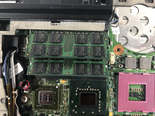

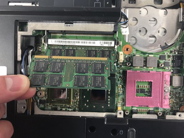

  17. Dell XPS M1330 Keyboard Replacement: crwdns2935265:017crwdnd2935265:01crwdnd2935265:03crwdne2935265:0 Dell XPS M1330 Keyboard Replacement: crwdns2935265:017crwdnd2935265:02crwdnd2935265:03crwdne2935265:0 Dell XPS M1330 Keyboard Replacement: crwdns2935265:017crwdnd2935265:03crwdnd2935265:03crwdne2935265:0
    • Separate the two clips on both sides of the memory sticks.
    • The memory stick will lift up.
    • Gently pull the memory stick up and out of its holder.
    • Repeat these same steps for the second memory stick below.

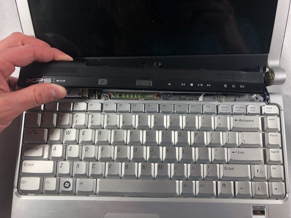

  21. Dell XPS M1330 Keyboard Replacement: crwdns2935265:021crwdnd2935265:01crwdnd2935265:02crwdne2935265:0 Dell XPS M1330 Keyboard Replacement: crwdns2935265:021crwdnd2935265:02crwdnd2935265:02crwdne2935265:0
    • Carefully lift the computer, so you can get a good grip by the hinges.
    • Carefully lift and remove the central control media button cover from the base.
    • This piece snaps out of its constraints. Be slow and controlled, so you don't break a snap. There is also a cable attached underneath.

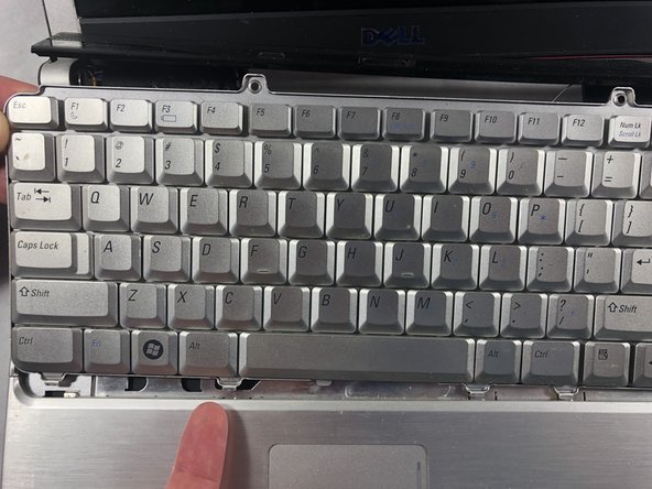

  22. Dell XPS M1330 Keyboard Replacement: crwdns2935265:022crwdnd2935265:01crwdnd2935265:01crwdne2935265:0
    • Use the Phillips #1 screwdriver to remove the two 3.0mm screws at the top of the keyboard.
  23. Dell XPS M1330 Keyboard Replacement: crwdns2935265:023crwdnd2935265:01crwdnd2935265:02crwdne2935265:0 Dell XPS M1330 Keyboard Replacement: crwdns2935265:023crwdnd2935265:02crwdnd2935265:02crwdne2935265:0
    • When removing this piece lift slowly as there is a cord underneath that connects to the keyboard.
    • Carefully lift the keyboard up and toward the front screen.
  24. Dell XPS M1330 Keyboard Replacement: crwdns2935265:024crwdnd2935265:01crwdnd2935265:02crwdne2935265:0 Dell XPS M1330 Keyboard Replacement: crwdns2935265:024crwdnd2935265:02crwdnd2935265:02crwdne2935265:0
    • Lift the keyboard latch toward yourself.
  25. Dell XPS M1330 Keyboard Replacement: crwdns2935265:025crwdnd2935265:01crwdnd2935265:02crwdne2935265:0 Dell XPS M1330 Keyboard Replacement: crwdns2935265:025crwdnd2935265:02crwdnd2935265:02crwdne2935265:0
    • Gently pull the keyboard cable away from your body.
    • Detach the keyboard cable.
