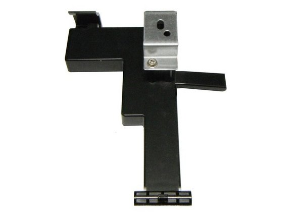

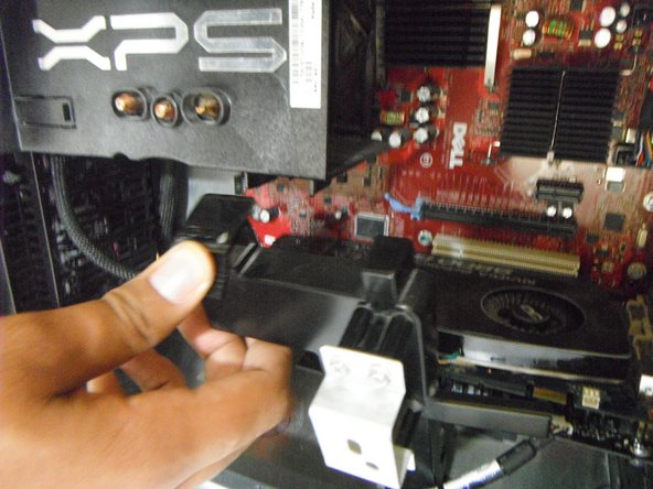

    2. Dell XPS 720 H2C Graphics Card Replacement: crwdns2935265:03crwdnd2935265:01crwdnd2935265:03crwdne2935265:0 Dell XPS 720 H2C Graphics Card Replacement: crwdns2935265:03crwdnd2935265:02crwdnd2935265:03crwdne2935265:0 Dell XPS 720 H2C Graphics Card Replacement: crwdns2935265:03crwdnd2935265:03crwdnd2935265:03crwdne2935265:0
      • Remove the support underneath the processor cooler by pressing down on the latch at the top of the support and pulling the support towards you.
