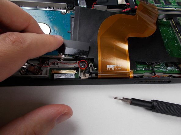

  8. Dell XPS 18 Upgrade to mSATA SSD, Unscrew the grounded plastic shield: crwdns2935265:09crwdnd2935265:01crwdnd2935265:02crwdne2935265:0 Dell XPS 18 Upgrade to mSATA SSD, Unscrew the grounded plastic shield: crwdns2935265:09crwdnd2935265:02crwdnd2935265:02crwdne2935265:0
    • There are two screws that hold this plastic sheet down because it's also a grounded shield. Use the #0 screwdriver to unscrew the screws shown in these photos.

  10. Dell XPS 18 Upgrade to mSATA SSD, Secure the plastic shield and the touch screen cables: crwdns2935265:011crwdnd2935265:01crwdnd2935265:02crwdne2935265:0 Dell XPS 18 Upgrade to mSATA SSD, Secure the plastic shield and the touch screen cables: crwdns2935265:011crwdnd2935265:02crwdnd2935265:02crwdne2935265:0
    • Screw the plastic shield back down.
    • Slip the connector ends of the flat cables back into their slots and use the flat end of the spudger to flip the clips back down.
