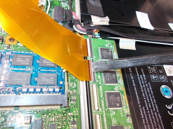

    • To access the mSATA and RAM slots we have to unclip the touch display cables and remove a plastic insulating sheet. It's easier than it sounds!
    • Use the pointy end of the spudger to flip the compression clips up to release the cables.

  8. Dell XPS 18 RAM Upgrade, Secure the plastic shield and the touch screen cables: crwdns2935265:09crwdnd2935265:01crwdnd2935265:02crwdne2935265:0 Dell XPS 18 RAM Upgrade, Secure the plastic shield and the touch screen cables: crwdns2935265:09crwdnd2935265:02crwdnd2935265:02crwdne2935265:0
    • Screw the plastic shield back down.
    • Slip the connector ends of the flat cables back into their slots and use the flat end of the spudger to flip the clips back down.
