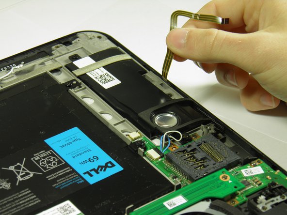

  4. Dell XPS 18 Left and Right Speakers Replacement, Left and Right Speakers: crwdns2935265:04crwdnd2935265:01crwdnd2935265:02crwdne2935265:0 Dell XPS 18 Left and Right Speakers Replacement, Left and Right Speakers: crwdns2935265:04crwdnd2935265:02crwdnd2935265:02crwdne2935265:0
    • Use the plastic opening tool's angled edge to lift the clasp securing the copper colored volume control cable.
    • Disconnect the volume control cable and pull it back.
  5. Dell XPS 18 Left and Right Speakers Replacement: crwdns2935265:05crwdnd2935265:01crwdnd2935265:01crwdne2935265:0
    • Firmly pull the blue speaker cable loose.
  6. Dell XPS 18 Left and Right Speakers Replacement: crwdns2935265:06crwdnd2935265:01crwdnd2935265:01crwdne2935265:0
    • Remove the two black 4mm screws with a Phillips 00 screwdriver.
  7. Dell XPS 18 Left and Right Speakers Replacement: crwdns2935265:07crwdnd2935265:01crwdnd2935265:01crwdne2935265:0
    • Carefully remove the speaker.
    • To remove the right speaker, follow these same steps.
