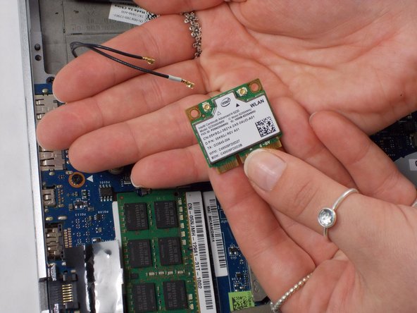

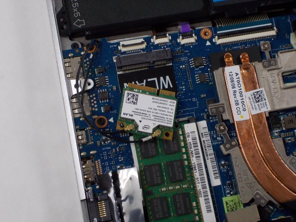

  9. Dell XPS 14 Wi-Fi Card Replacement, Wi-Fi Card: crwdns2935265:09crwdnd2935265:01crwdnd2935265:02crwdne2935265:0 Dell XPS 14 Wi-Fi Card Replacement, Wi-Fi Card: crwdns2935265:09crwdnd2935265:02crwdnd2935265:02crwdne2935265:0
    • Remove the Wi-Fi card by gently lifting the card and pulling it out of its slot.
  10. Dell XPS 14 Wi-Fi Card Replacement: crwdns2935265:010crwdnd2935265:01crwdnd2935265:02crwdne2935265:0 Dell XPS 14 Wi-Fi Card Replacement: crwdns2935265:010crwdnd2935265:02crwdnd2935265:02crwdne2935265:0
    • Disconnect the two coaxial cables from the Wi-Fi card to remove it from the laptop.
