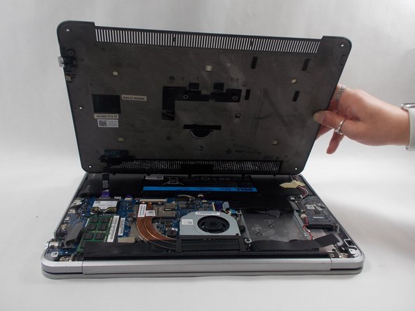

      • Use an opening tool to pop out the back panel.
      • Once unhinged, the panel will open away from you.
      • The back panel will still be attached by a ribbon cable. Be cautious when opening the panel to ensure the ribbon stays intact.

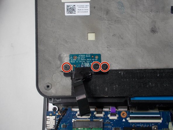

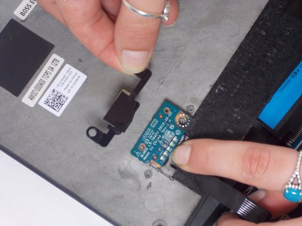

      • Flip over the back panel so that the interior of the panel is facing up.
      • Remove three 2 mm screws that are connected to the vendor GCE disk on the bottom left corner of the back panel using a Phillips #0 screwdriver.
      • Remove the black plastic cover that holds the disk in place.
      • Remove the back panel.
      • The GCE disk should still be connected to the computer via a purple ribbon cable.

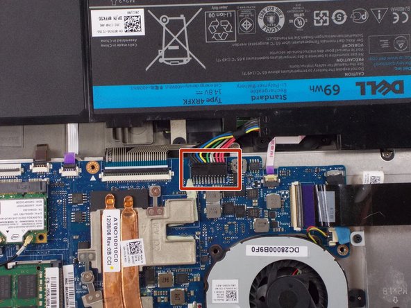

    1. Dell XPS 14 RAM Replacement, Battery: crwdns2935265:07crwdnd2935265:01crwdnd2935265:01crwdne2935265:0
      • Make sure to ground yourself before removing the battery.
      • Remove the four 6 mm screws from the sides of the battery using a T5 Torx screwdriver.
      • Remove the two 3 mm screws from the top of the battery using a Phillips #0 screwdriver.
    2. Dell XPS 14 RAM Replacement: crwdns2935265:08crwdnd2935265:01crwdnd2935265:03crwdne2935265:0 Dell XPS 14 RAM Replacement: crwdns2935265:08crwdnd2935265:02crwdnd2935265:03crwdne2935265:0 Dell XPS 14 RAM Replacement: crwdns2935265:08crwdnd2935265:03crwdnd2935265:03crwdne2935265:0
      • Detach the battery connector from the motherboard using two thumbs to pop it out.
      • Remove the battery from the laptop.

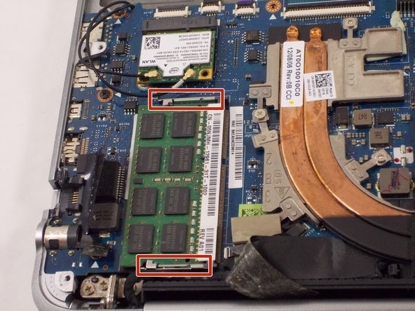

    1. Dell XPS 14 RAM Replacement, RAM: crwdns2935265:09crwdnd2935265:01crwdnd2935265:03crwdne2935265:0 Dell XPS 14 RAM Replacement, RAM: crwdns2935265:09crwdnd2935265:02crwdnd2935265:03crwdne2935265:0 Dell XPS 14 RAM Replacement, RAM: crwdns2935265:09crwdnd2935265:03crwdnd2935265:03crwdne2935265:0
      • Remove any electrical tape that may be covering or overlapping the RAM cartridge.
      • Push the two metal latches on either side of the RAM outward.
      • The cartridge will pop out of the laptop.

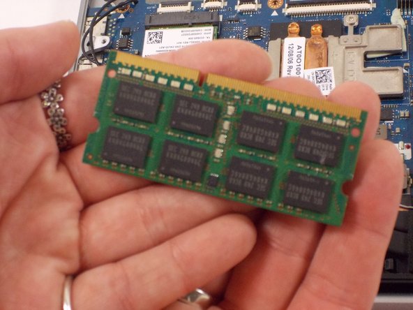

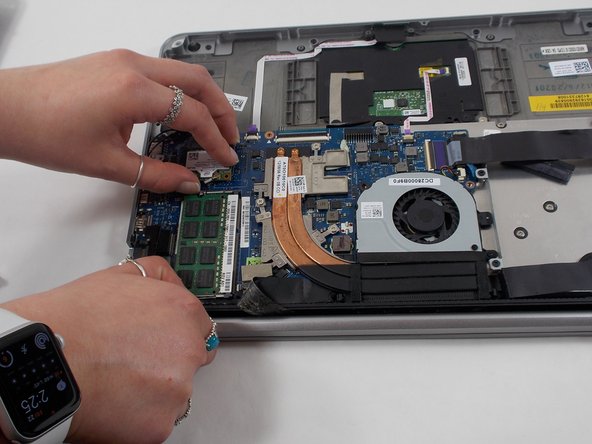

    2. Dell XPS 14 RAM Replacement: crwdns2935265:010crwdnd2935265:01crwdnd2935265:02crwdne2935265:0 Dell XPS 14 RAM Replacement: crwdns2935265:010crwdnd2935265:02crwdnd2935265:02crwdne2935265:0
      • Slide the RAM cartridge out of its slot.
