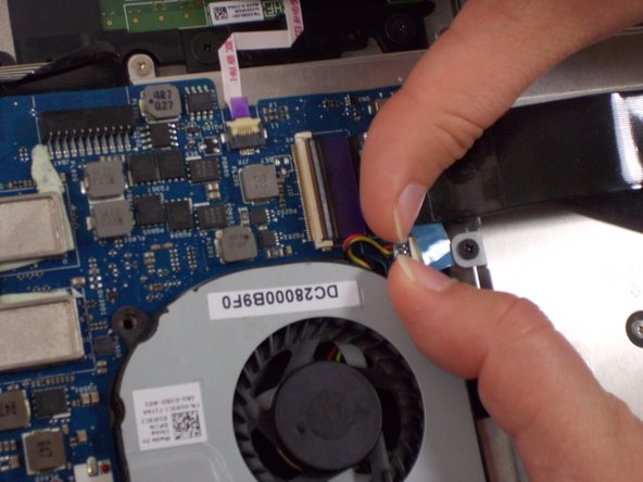

    1. Dell XPS 14 Fan Replacement, Fan: crwdns2935265:09crwdnd2935265:01crwdnd2935265:01crwdne2935265:0
      • Remove the two 2 mm screws from the fan using a Phillips #0 screwdriver.
    2. Dell XPS 14 Fan Replacement: crwdns2935265:010crwdnd2935265:01crwdnd2935265:02crwdne2935265:0 Dell XPS 14 Fan Replacement: crwdns2935265:010crwdnd2935265:02crwdnd2935265:02crwdne2935265:0
      • Use two thumbs to pop out the plug that connects the fan to the laptop.
      • Remove the fan from the laptop.
