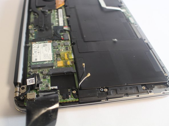

    • Remove the black tape covering the RAM and wireless card with your hands.

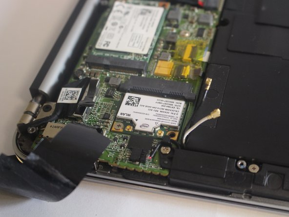

    • Use a plastic iFixit opening tool to remove the two wires connected to the wireless card.

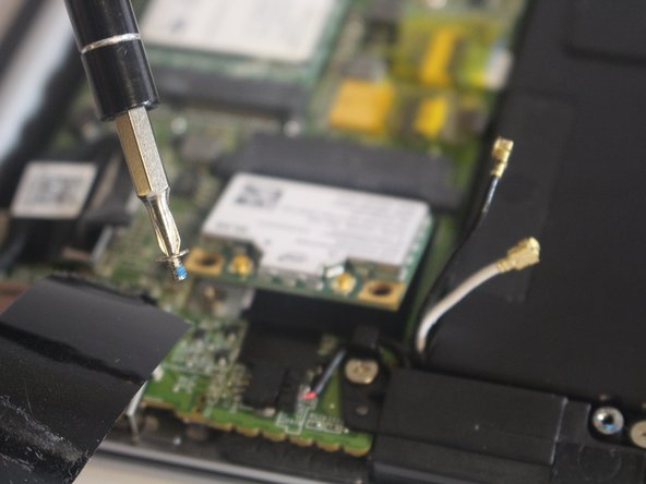

    • Use a PH00 screwdriver to remove the one 3mm screw that holds the wireless card in place.

    • Use your hand to remove the wireless card.
