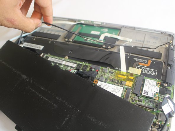

    • Remove the black wire that connects the screen to the motherboard by pulling up with a plastic iFixit opening tool.

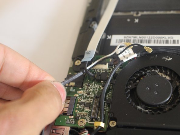

    • Disconnect the ribbon cable with a plastic iFixit opening tool by lifting up the black clip and pulling the white ribbon off.
    • Pull aside the ribbon cable.

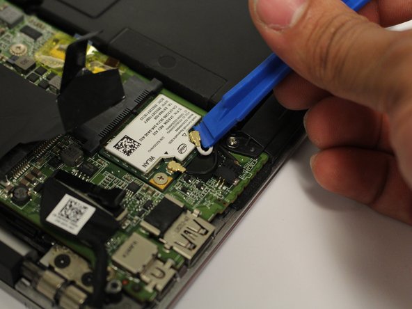

    • Disconnect the wire that is connected to the wireless card with a plastic iFixit opening tool by lifting up slowly, then pulling the wires aside.

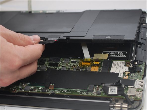

    • Use a PH00 size screwdriver to remove the 8 screws that secure the battery.
    • Six 3mm screws.
    • Two 5mm screws.
  7. Dell XPS 13 L321X Screen Replacement: crwdns2935265:07crwdnd2935265:01crwdnd2935265:02crwdne2935265:0 Dell XPS 13 L321X Screen Replacement: crwdns2935265:07crwdnd2935265:02crwdnd2935265:02crwdne2935265:0
    • Insert a plastic iFixit opening tool in between the port and the wires to remove the battery cable.

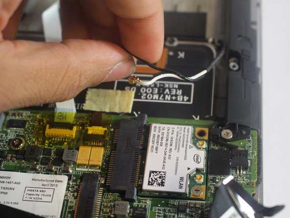

    • After removing the battery, start to remove the wireless wire and making it through the other wires connected under the battery.

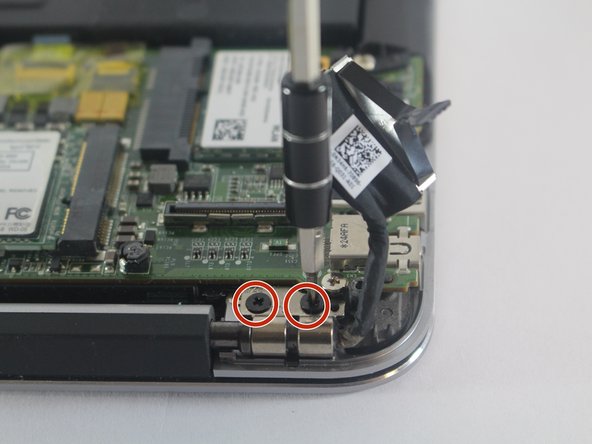

    • Remove the screws with a PH1 size screwdriver.
    • Each side of the brackets that are holding the screen down are going to have two 3mm screws in each side.

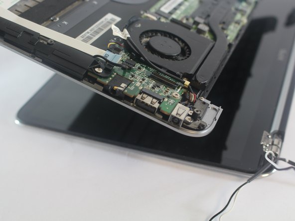

  10. Dell XPS 13 L321X Screen Replacement: crwdns2935265:010crwdnd2935265:01crwdnd2935265:03crwdne2935265:0 Dell XPS 13 L321X Screen Replacement: crwdns2935265:010crwdnd2935265:02crwdnd2935265:03crwdne2935265:0 Dell XPS 13 L321X Screen Replacement: crwdns2935265:010crwdnd2935265:03crwdnd2935265:03crwdne2935265:0

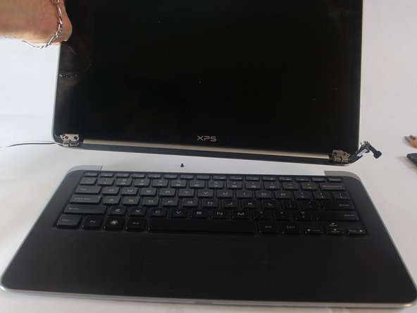

    • Open the laptop by separating the screen from the actual laptop and take it apart.

That would be the guide to take off the upper DISPLAY ASSEMBLY, not the screen.
I was expecting you to bring iOpeners and get the actual glass LCD out …
But it’s a good guide.
Xavier Jiang - crwdns2934203:0crwdne2934203:0 crwdns2950251:0crwdne2950251:0
Is there a way only the screen can be replaced on Dell XPS 13, not the entire display assembly. From what I have got so far, the entire panel above the keyboard is a single unit
