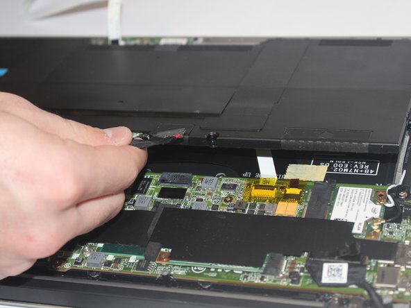

  3. Dell XPS 13 L321X Mouse pad Replacement: crwdns2935265:03crwdnd2935265:01crwdnd2935265:01crwdne2935265:0
    • With a plastic iFixit opeing tool, insert it in between and remove the battery cable.

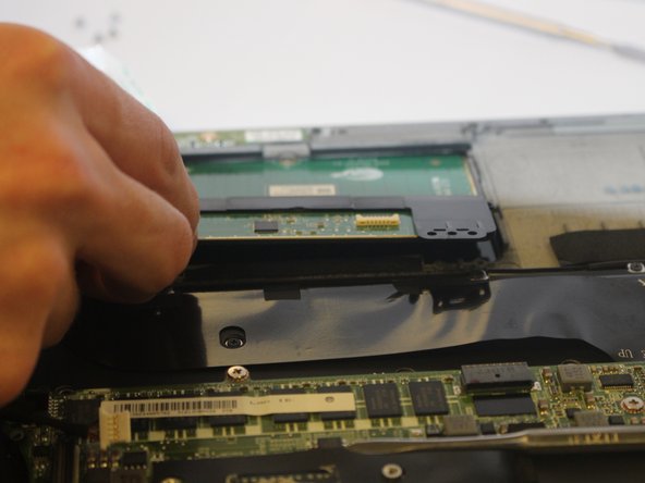

  5. Dell XPS 13 L321X Mouse pad Replacement: crwdns2935265:05crwdnd2935265:01crwdnd2935265:01crwdne2935265:0
    • Disconnect the ribbon cable with a plastic iFixit opening tool by lifting up the black clip and by pulling the white ribbon.
    • Place aside.

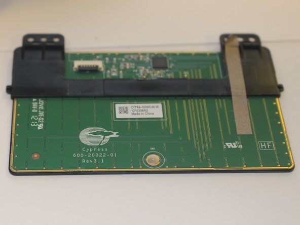

  6. Dell XPS 13 L321X Mouse pad Replacement: crwdns2935265:06crwdnd2935265:01crwdnd2935265:03crwdne2935265:0 Dell XPS 13 L321X Mouse pad Replacement: crwdns2935265:06crwdnd2935265:02crwdnd2935265:03crwdne2935265:0 Dell XPS 13 L321X Mouse pad Replacement: crwdns2935265:06crwdnd2935265:03crwdnd2935265:03crwdne2935265:0
    • Remove four 2mm screws with a PH00 screwdriver.
    • Remove the mouse pad.
