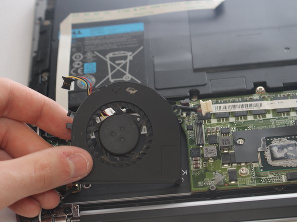

Dell XPS 13 L321X Fan Replacement
  1. Dell XPS 13 L321X Fan Replacement, Fan: crwdns2935265:01crwdnd2935265:01crwdnd2935265:02crwdne2935265:0 Dell XPS 13 L321X Fan Replacement, Fan: crwdns2935265:01crwdnd2935265:02crwdnd2935265:02crwdne2935265:0
    • Remove ten 3mm screws from the back cover with a T5 screwdriver.
  2. Dell XPS 13 L321X Fan Replacement: crwdns2935265:02crwdnd2935265:01crwdnd2935265:01crwdne2935265:0
    • Remove the ribbons from both sides with a plastic iFixit opening tool.
  3. Dell XPS 13 L321X Fan Replacement: crwdns2935265:03crwdnd2935265:01crwdnd2935265:01crwdne2935265:0
    • Use a PH1 screwdriver to remove the two 3mm screws that secure the fan.
  4. Dell XPS 13 L321X Fan Replacement: crwdns2935265:04crwdnd2935265:01crwdnd2935265:02crwdne2935265:0 Dell XPS 13 L321X Fan Replacement: crwdns2935265:04crwdnd2935265:02crwdnd2935265:02crwdne2935265:0
    • Use a plastic iFixit opening tool to remove the wire connected to the fan.
    • Lift the fan up to remove.
