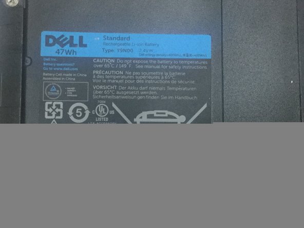

    • The entire thing was fixed to the palm rest, as most modern computers do.
    • The Dell Inspiron 13z 5323, however, was the opposite, featuring things tied down the the back cover, and you will remove the palmrest for disassembly.
    • Weird ...
    • The tabs holding down the 47 WH battery had cracked on mine due to age. Make sure these screws are not screwed in too tight during reassembly.
    • The screws are also a bit prone to rusting for some reason, but so far none of mine had stripped.

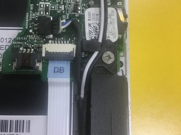

    • The ribbon cable connects basically half of the machine to the other.
    • Electricity from the plug is directly connected to the motherboard through a plug beneath it.
    • Don't forget about the keyboard's TWO cables-the "keys" and the backlight. They are held down by unnecessary adhesive. (but keep them there, so you won't snag them)
    • Use a tweezer/opener on the cable housing, but it's OKAY to use hand as long as you are gentle. I would recommend ... plastic spoons.

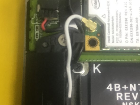

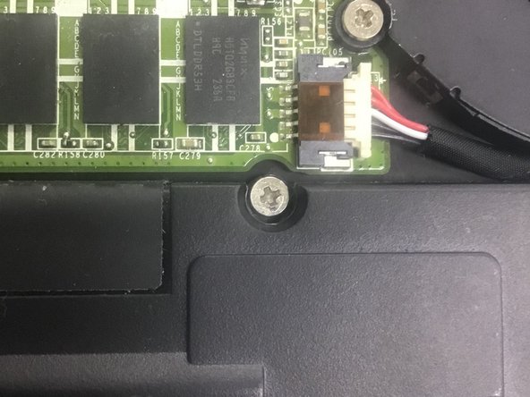

    • Now, lift that big slab of battery off. (basically taking everything you can out of the thing.) Then the fan.
    • The screw in this picture is a big white one (it may be not), because you end up with one extra big white one after using up all the multi-layer holes.
    • Now it's a good time to wash the fan. (it's okay to do it with water, I did it that way.) Just make sure they are 200% dry before connecting them to power.
    • Take out those speakers--those are going to get into your way when you try to lift off the motherboard.
    • At least, the right one.
    • Pictured are the proper wiring of the left and right speakers. (ESPECIALLY the right sided one -- the one on the motherboard)

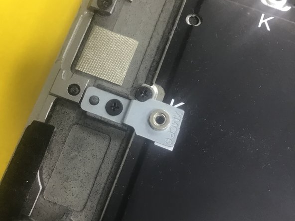

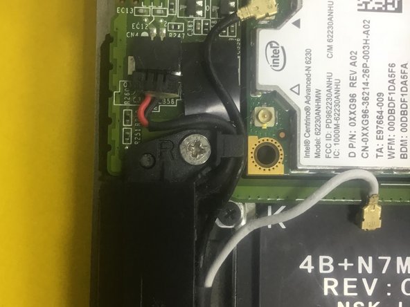

    • FOURTY screw holes? What is this keyboard made of, paper?
    • Immediate headache.
    • Take off ALL the screws you encounter. I think it is 27. I lost count.
    • But there are more holes then there are for screws!
    • Well, the screw holes with letter "K" NEARBY (within 3mm radius) are for keyboard screws. The other ones are not. (and are for, for example, the motherboard.)
    • Now, this one right above the touchpad IS a keyboard screw, despite the fact that it don't have letter 'K' on it. (they can't print it on the ribbon cable, duh)
    • Don't forget this ... what should I call it? Bracket thing for the WLAN card. The picture here is the WRONG screw -- you should have a slightly larger Philips screw to secure this down.

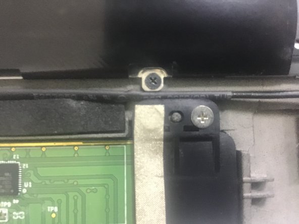

    • The hinge?
    • TOUGH screws. Use Philips #0 for the sake of your screwdriver ( and the screws!)
    • One side is the display thing. the other is the antenna...
    • There are three holes, but only two holes for the screws to go to (on the "palm rest")
    • Ah, and Dell had a cute little screw here to keep the power button in place! Lovely.
    • Too bad that for some reason I can't unscrew it. Bummer.
