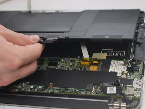

Dell XPS 13 L321X Battery Replacement
  1. Dell XPS 13 L321X Battery Replacement, Battery: crwdns2935265:01crwdnd2935265:01crwdnd2935265:02crwdne2935265:0 Dell XPS 13 L321X Battery Replacement, Battery: crwdns2935265:01crwdnd2935265:02crwdnd2935265:02crwdne2935265:0
    • Remove ten 3mm screws from the back cover with a T5 screwdriver.
  2. Dell XPS 13 L321X Battery Replacement: crwdns2935265:02crwdnd2935265:01crwdnd2935265:02crwdne2935265:0 Dell XPS 13 L321X Battery Replacement: crwdns2935265:02crwdnd2935265:02crwdnd2935265:02crwdne2935265:0
    • Disconnect the ribbon cable with a plastic iFixit opening tool by lifting up the black clip and pulling the white ribbon off.
    • Pull aside the ribbon cable.
  3. Dell XPS 13 L321X Battery Replacement: crwdns2935265:03crwdnd2935265:01crwdnd2935265:01crwdne2935265:0
    • Insert a plastic iFixit opening tool in between the port and the wires to remove the battery cable.
  4. Dell XPS 13 L321X Battery Replacement: crwdns2935265:04crwdnd2935265:01crwdnd2935265:02crwdne2935265:0 Dell XPS 13 L321X Battery Replacement: crwdns2935265:04crwdnd2935265:02crwdnd2935265:02crwdne2935265:0
    • Take out 8 silver screws that are holding the battery with a PH00 head screwdriver.
    • Six 3mm screws.
    • Two 5mm screws.
    • Lift the battery out.
