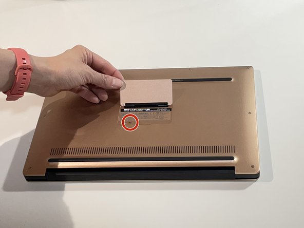

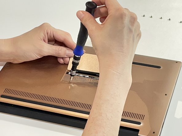

    • Lift the small magnetic flap cover in the center of the back case.
    • Use a JIS J0 screwdriver to remove the 6 mm screw under the flap cover.

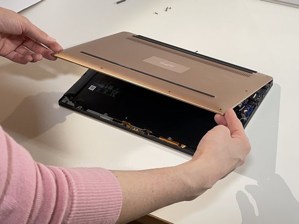

  5. Dell XPS 13 9360 SSD Replacement: crwdns2935265:05crwdnd2935265:01crwdnd2935265:03crwdne2935265:0 Dell XPS 13 9360 SSD Replacement: crwdns2935265:05crwdnd2935265:02crwdnd2935265:03crwdne2935265:0 Dell XPS 13 9360 SSD Replacement: crwdns2935265:05crwdnd2935265:03crwdnd2935265:03crwdne2935265:0
    • Wedge the guitar pick between the cover and the base of the laptop.
    • Start at the front edge of the base cover and continue around the perimeter of the laptop, carefully prying up the base cover.
    • Pull off the base cover.
    • As you use the guitar pick to work around the base cover, it will gradually loosen. You can then gently pull it off completely.

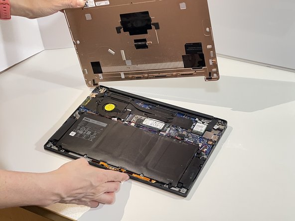

  6. Dell XPS 13 9360 SSD Replacement: crwdns2935265:06crwdnd2935265:01crwdnd2935265:03crwdne2935265:0 Dell XPS 13 9360 SSD Replacement: crwdns2935265:06crwdnd2935265:02crwdnd2935265:03crwdne2935265:0 Dell XPS 13 9360 SSD Replacement: crwdns2935265:06crwdnd2935265:03crwdnd2935265:03crwdne2935265:0
    • Disconnect the battery before removing the SSD.
    • Use the JIS J0 screwdriver to remove the single 2 mm screw securing the existing SSD.
    • The SSD will automatically "pop up".
    • Gently slide it out from the socket.
