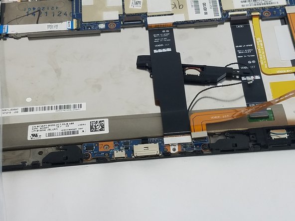

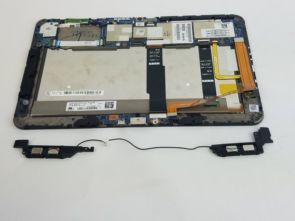

    • Use the plastic opening tools to lift up the black cable shown in the picture.
    • Slide one end of the speaker to the other side and the speaker will be out.

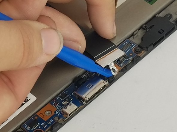

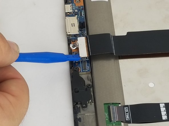

    • Unscrew the shown screw in the picture.
    • Remove the silver tape using the plastic tool as shown in the picture.
    • Note: be careful when removing the tape as it is fragile.

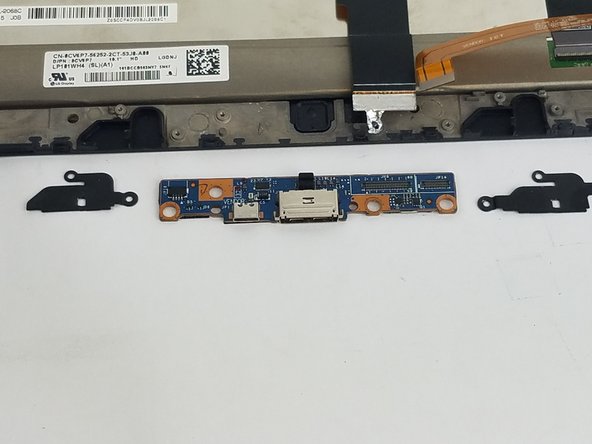

    • Unscrew the three screws shown in the picture.
    • 3 mm screws.

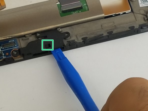

    • Slide the small piece shown in green square on both black pieces and lift them up using the plastic tool as shown in the picture.
    • Finally, take the USB port out. You will have three pieces out: the port and the two black pieces as shown in the picture.
