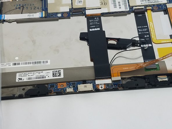

    • Unscrew the three black, 4mm screws with a phillips screwdriver size PH 0 (one of which is under the gold colored ribbon cable.)
    • Unscrew the three gray, 3mm screws with the same screwdriver (phillips screwdriver size PH 0.)
    • Unplug the connector the connects the battery to the mother board.
    • Make sure to use a plastic opening tool instead of a metal spudger to avoid any unnecessary accidental shorting out of components.

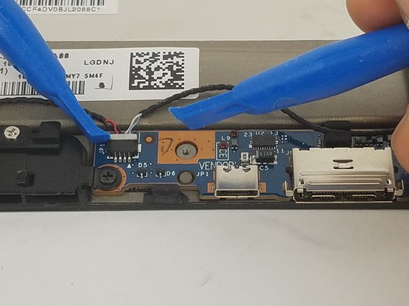

    • Use the opening tools to unplug the gold/orange ribbon cable.
    • Use the opening tools to unplug the speakers from the motherboard.

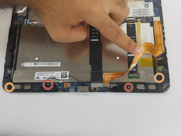

    • Use a Phillips #0 screwdriver to remove two 4 mm screws.
    • Use a Phillips #0 screwdriver to remove two 3 mm screws.
    • Do not miss the screw under the gold/orange ribbon cable.

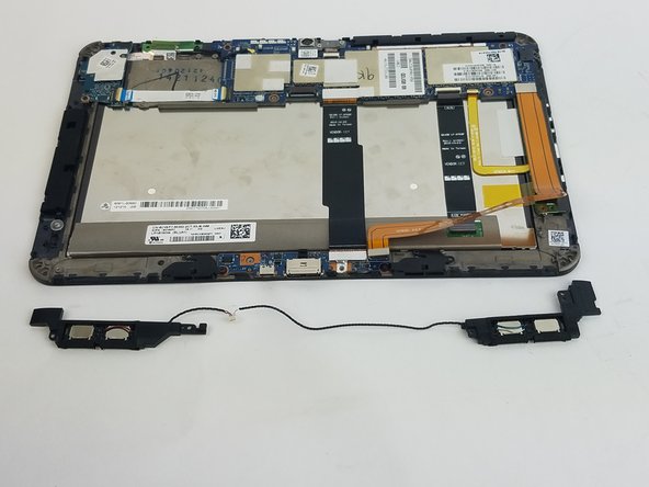

    • Use the plastic opening tools to lift up the black cable.
    • While holding the cable up, slide one end of the speaker to the other side under the cable and remove the speaker.
