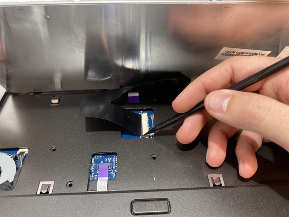

  5. Dell Wyse Xn0m Mouse Sensor Board Replacement: crwdns2935265:05crwdnd2935265:01crwdnd2935265:01crwdne2935265:0
    • Pry open the laptop with the plastic opening tool.
  6. Dell Wyse Xn0m Mouse Sensor Board Replacement: crwdns2935265:06crwdnd2935265:01crwdnd2935265:02crwdne2935265:0 Dell Wyse Xn0m Mouse Sensor Board Replacement: crwdns2935265:06crwdnd2935265:02crwdnd2935265:02crwdne2935265:0

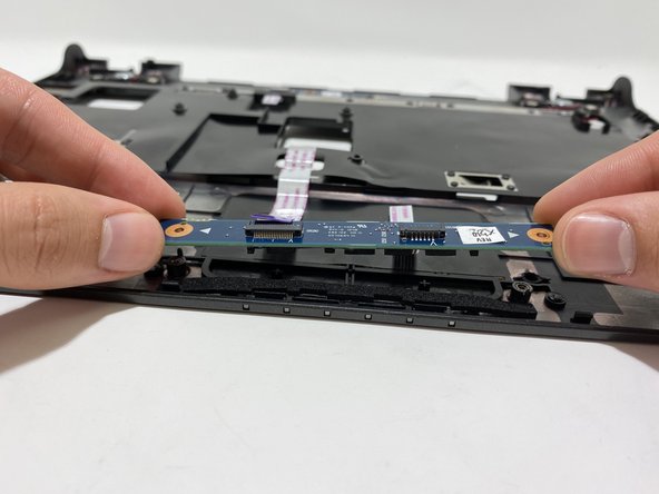

    • Under the trackpad, detach the ribbon cables with the spudger.
    • Unscrew two 3mm Phillips #1 screws and lift the board from the pegs.
    • Remove the board from the laptop.
