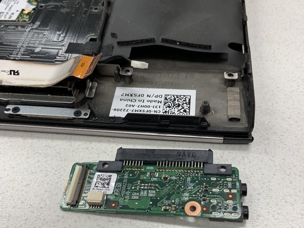

    1. Dell Vostro V13 Sound Card Replacement, Sound Card: crwdns2935265:07crwdnd2935265:01crwdnd2935265:02crwdne2935265:0 Dell Vostro V13 Sound Card Replacement, Sound Card: crwdns2935265:07crwdnd2935265:02crwdnd2935265:02crwdne2935265:0
      • Remove the black 3.0 mm Phillips #1 screw.
      • Remove the two 5.1 mm silver Phillips #1 screws.
    2. Dell Vostro V13 Sound Card Replacement: crwdns2935265:08crwdnd2935265:01crwdnd2935265:02crwdne2935265:0 Dell Vostro V13 Sound Card Replacement: crwdns2935265:08crwdnd2935265:02crwdnd2935265:02crwdne2935265:0
      • Disconnect the white plug on the top left corner of the sound card.
    3. Dell Vostro V13 Sound Card Replacement: crwdns2935265:09crwdnd2935265:01crwdnd2935265:02crwdne2935265:0 Dell Vostro V13 Sound Card Replacement: crwdns2935265:09crwdnd2935265:02crwdnd2935265:02crwdne2935265:0
      • Use the plastic opening tool to flip the ribbon connector up.
    4. Dell Vostro V13 Sound Card Replacement: crwdns2935265:010crwdnd2935265:01crwdnd2935265:02crwdne2935265:0 Dell Vostro V13 Sound Card Replacement: crwdns2935265:010crwdnd2935265:02crwdnd2935265:02crwdne2935265:0
      • Pull the sound card out of the laptop.
