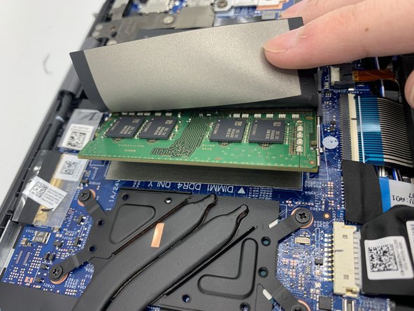

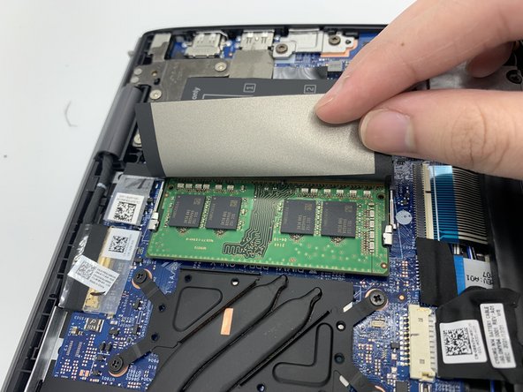

  5. Dell Vostro 5510 RAM Replacement, RAM: crwdns2935265:05crwdnd2935265:01crwdnd2935265:02crwdne2935265:0 Dell Vostro 5510 RAM Replacement, RAM: crwdns2935265:05crwdnd2935265:02crwdnd2935265:02crwdne2935265:0
    • Locate the memory board.
    • Lift the Mylar to access the memory board.
  6. Dell Vostro 5510 RAM Replacement: crwdns2935265:06crwdnd2935265:01crwdnd2935265:02crwdne2935265:0 Dell Vostro 5510 RAM Replacement: crwdns2935265:06crwdnd2935265:02crwdnd2935265:02crwdne2935265:0
    • Pull the securing clips from both sides of the memory module outwards until the memory board pops up.
    • Remove the memory board from the memory-module slot.
