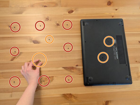

  2. Dell Vostro 3590 Battery Replacement: crwdns2935265:02crwdnd2935265:01crwdnd2935265:03crwdne2935265:0 Dell Vostro 3590 Battery Replacement: crwdns2935265:02crwdnd2935265:02crwdnd2935265:03crwdne2935265:0 Dell Vostro 3590 Battery Replacement: crwdns2935265:02crwdnd2935265:03crwdnd2935265:03crwdne2935265:0

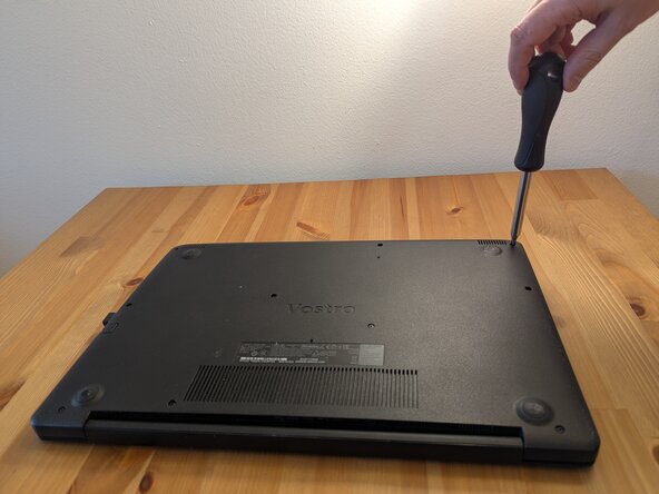

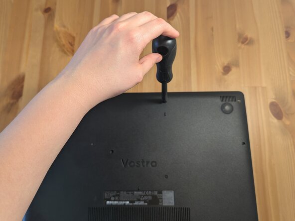

    • Unscrew the back panel using a Phillips #0 screwdriver.
    • The screws vary in size, so place them in a memorable order for future assembly.

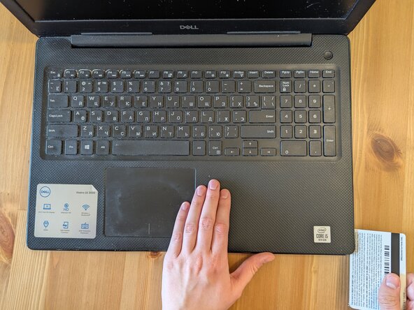

  3. Dell Vostro 3590 Battery Replacement: crwdns2935265:03crwdnd2935265:01crwdnd2935265:03crwdne2935265:0 Dell Vostro 3590 Battery Replacement: crwdns2935265:03crwdnd2935265:02crwdnd2935265:03crwdne2935265:0 Dell Vostro 3590 Battery Replacement: crwdns2935265:03crwdnd2935265:03crwdnd2935265:03crwdne2935265:0

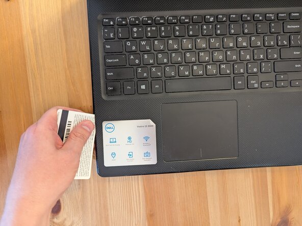

    • Return the laptop to its normal position and open it.
    • Locate the seam at the corner of the laptop and gently insert a pry tool or a plastic card into the gap.
    • DON'T use an active credit card or ID. Instead, take a card you no longer need because it might get damaged.
    • Carefully slide the tool or card along the seam to separate the panels.

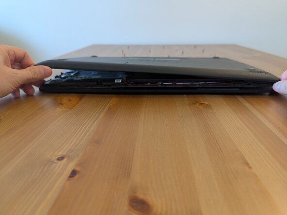

  4. Dell Vostro 3590 Battery Replacement: crwdns2935265:04crwdnd2935265:01crwdnd2935265:02crwdne2935265:0 Dell Vostro 3590 Battery Replacement: crwdns2935265:04crwdnd2935265:02crwdnd2935265:02crwdne2935265:0
    • Turn the laptop over so that the back panel is facing up.
    • Remove the back panel by lifting upwards.

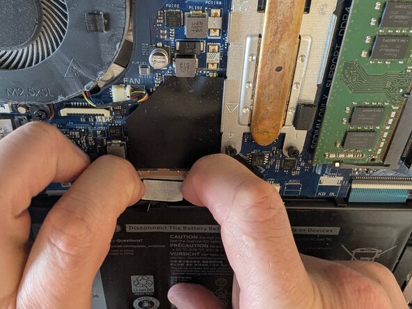

  5. Dell Vostro 3590 Battery Replacement: crwdns2935265:05crwdnd2935265:01crwdnd2935265:01crwdne2935265:0

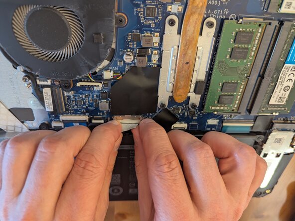

    • Locate the battery and the cable.
    • The battery is attached to the motherboard with a cable.
    • If the battery is hot or warm to touch, wait until it's cooled down before proceeding.
  6. Dell Vostro 3590 Battery Replacement: crwdns2935265:06crwdnd2935265:01crwdnd2935265:03crwdne2935265:0 Dell Vostro 3590 Battery Replacement: crwdns2935265:06crwdnd2935265:02crwdnd2935265:03crwdne2935265:0 Dell Vostro 3590 Battery Replacement: crwdns2935265:06crwdnd2935265:03crwdnd2935265:03crwdne2935265:0

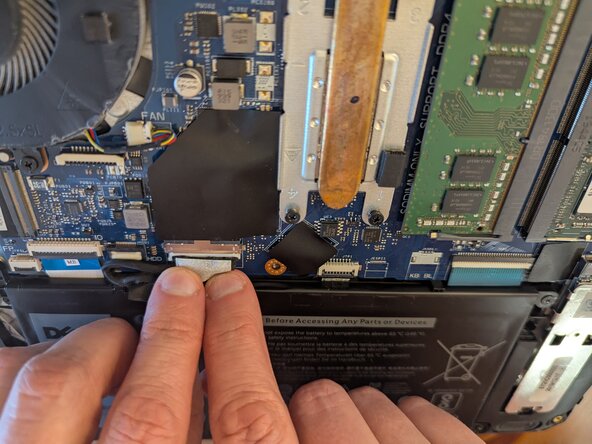

    • Carefully pull the battery cable out of the socket on the motherboard.

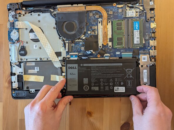

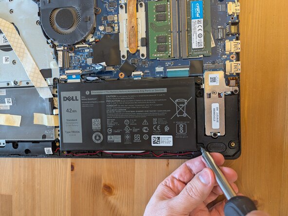

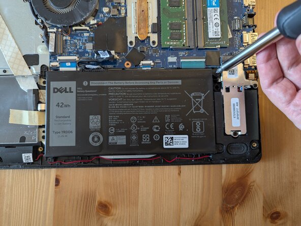

    • Remove four screws holding the battery in place.
    • Lift and remove the battery.

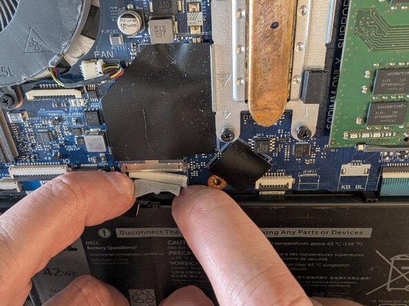

  8. Dell Vostro 3590 Battery Replacement: crwdns2935265:08crwdnd2935265:01crwdnd2935265:03crwdne2935265:0 Dell Vostro 3590 Battery Replacement: crwdns2935265:08crwdnd2935265:02crwdnd2935265:03crwdne2935265:0 Dell Vostro 3590 Battery Replacement: crwdns2935265:08crwdnd2935265:03crwdnd2935265:03crwdne2935265:0

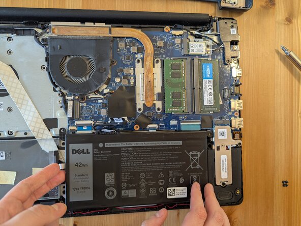

    • Make sure it's a Dell 11.4V battery. Using the incorrect battery wattage may be hazardous.
    • Place the new battery exactly where the old one was. Ensure that the battery logo is facing the same direction.
    • Secure it with the original four screws.
  9. Dell Vostro 3590 Battery Replacement: crwdns2935265:09crwdnd2935265:01crwdnd2935265:03crwdne2935265:0 Dell Vostro 3590 Battery Replacement: crwdns2935265:09crwdnd2935265:02crwdnd2935265:03crwdne2935265:0 Dell Vostro 3590 Battery Replacement: crwdns2935265:09crwdnd2935265:03crwdnd2935265:03crwdne2935265:0
    • Plug the cable back into the motherboard.
    • Make sure that the white part of the cable fits perfectly into the metal socket on the motherboard.

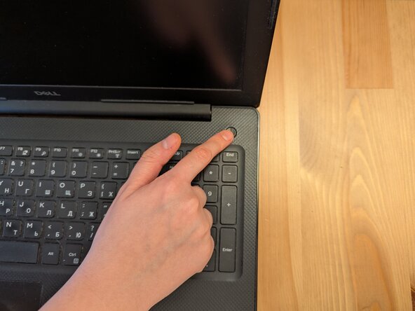

  11. Dell Vostro 3590 Battery Replacement: crwdns2935265:011crwdnd2935265:01crwdnd2935265:02crwdne2935265:0 Dell Vostro 3590 Battery Replacement: crwdns2935265:011crwdnd2935265:02crwdnd2935265:02crwdne2935265:0
    • Plug in and turn on the laptop.
    • Check the battery status in the lower right corner of the display.
    • Run a battery report if any concerns arise.
    • The repair is finished after you ensure that the battery is working properly!
