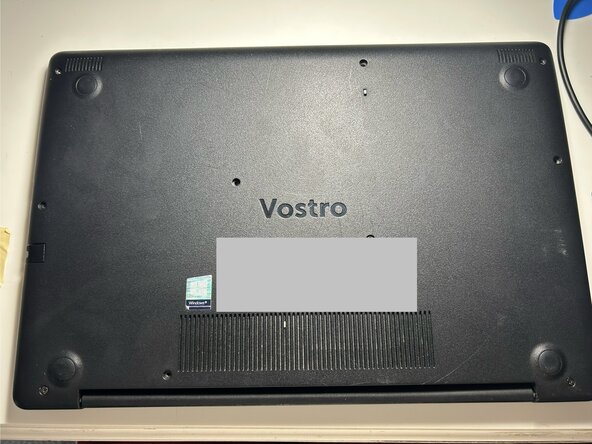

  2. Dell Vostro 3583 SSD/Memory Replacement, Remove the Cover: crwdns2935265:02crwdnd2935265:01crwdnd2935265:01crwdne2935265:0
    • Using a philips head size 1, unscrew all 10 screws and unclip brackets with a pick.

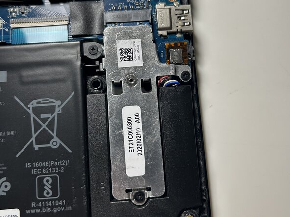

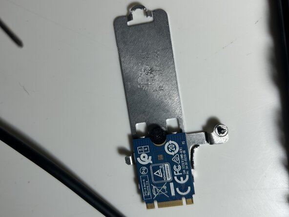

  5. Dell Vostro 3583 SSD/Memory Replacement, M.2 NVME SSD: crwdns2935265:06crwdnd2935265:01crwdnd2935265:03crwdne2935265:0 Dell Vostro 3583 SSD/Memory Replacement, M.2 NVME SSD: crwdns2935265:06crwdnd2935265:02crwdnd2935265:03crwdne2935265:0 Dell Vostro 3583 SSD/Memory Replacement, M.2 NVME SSD: crwdns2935265:06crwdnd2935265:03crwdnd2935265:03crwdne2935265:0
    • Here you can find your primary storage. You can upgrade or remove this by unscrewing the two front screws, then removing it. To remove the plate, remove the tiny screw using a PH 000 screwdriver.
