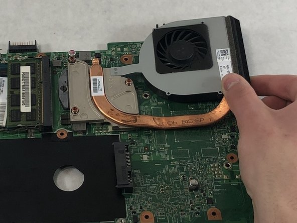

  19. Dell Vostro 3550 Fan Replacement, Fan: crwdns2935265:019crwdnd2935265:01crwdnd2935265:02crwdne2935265:0 Dell Vostro 3550 Fan Replacement, Fan: crwdns2935265:019crwdnd2935265:02crwdnd2935265:02crwdne2935265:0
    • Flip over the motherboard to access the fan assembly.

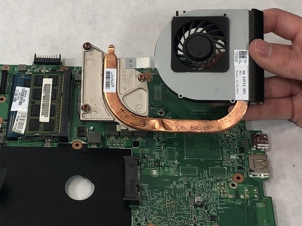

  20. Dell Vostro 3550 Fan Replacement: crwdns2935265:020crwdnd2935265:01crwdnd2935265:02crwdne2935265:0 Dell Vostro 3550 Fan Replacement: crwdns2935265:020crwdnd2935265:02crwdnd2935265:02crwdne2935265:0
    • Remove the four 5mm Phillips #0 screws that are holding the fan down onto the motherboard.
    • Remove the three brass 8mm Phillips #0 screws fastening the heatsink to the motherboard.
  21. Dell Vostro 3550 Fan Replacement: crwdns2935265:021crwdnd2935265:01crwdnd2935265:03crwdne2935265:0 Dell Vostro 3550 Fan Replacement: crwdns2935265:021crwdnd2935265:02crwdnd2935265:03crwdne2935265:0 Dell Vostro 3550 Fan Replacement: crwdns2935265:021crwdnd2935265:03crwdnd2935265:03crwdne2935265:0
    • Gently lift the fan assembly and heatsink away from the motherboard, and put it down onto a flat surface.

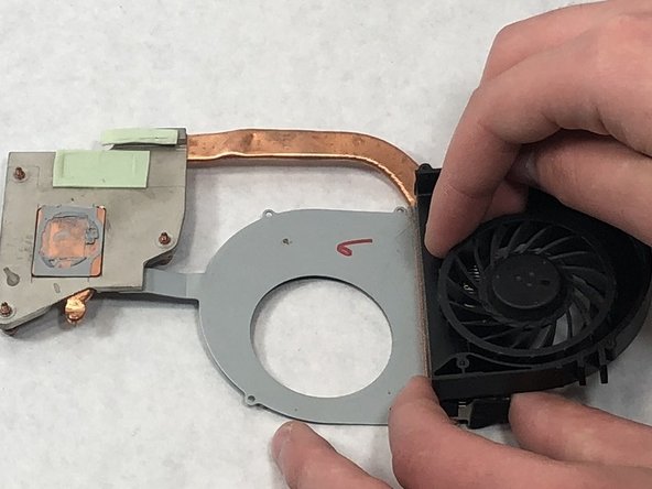

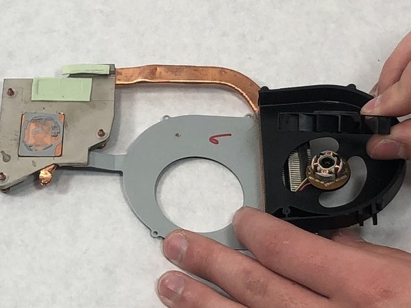

    • Once placed down, flip the fan casing upside down to expose the bottom shell of the fan.
    • Grab the shell of the fan and pull upwards.
    • Rest the shell of the fan on its hinge to reveal the blades of the fan.
  23. Dell Vostro 3550 Fan Replacement: crwdns2935265:023crwdnd2935265:01crwdnd2935265:03crwdne2935265:0 Dell Vostro 3550 Fan Replacement: crwdns2935265:023crwdnd2935265:02crwdnd2935265:03crwdne2935265:0 Dell Vostro 3550 Fan Replacement: crwdns2935265:023crwdnd2935265:03crwdnd2935265:03crwdne2935265:0
    • Gently pull upwards on the fan to separate the fan from the motor.
  24. Dell Vostro 3550 Fan Replacement: crwdns2935265:024crwdnd2935265:01crwdnd2935265:01crwdne2935265:0
    • Once the fan is removed, gently push the new one onto the motor.
