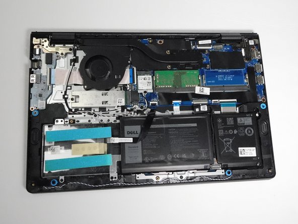

    • Ensure the laptop is powered off.
    • Flip the laptop over.
  2. Dell Vostro 3510 Display Replacement: crwdns2935265:02crwdnd2935265:01crwdnd2935265:01crwdne2935265:0
    Magnetic Project Mat
    $19.95
    • Use a Phillips #0 screwdriver to remove the six 1 mm screws (circled in red).
    • Loosen the two captive 1 mm screws on the back corners.
    • Keep track of each screw and make sure it goes back exactly where it came from to avoid damaging your laptop.

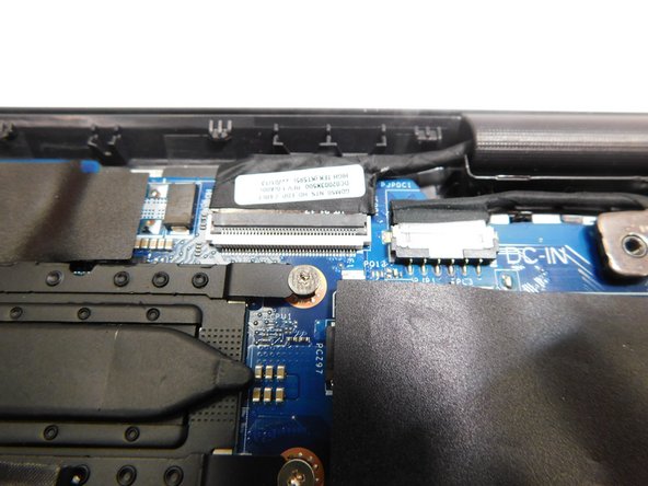

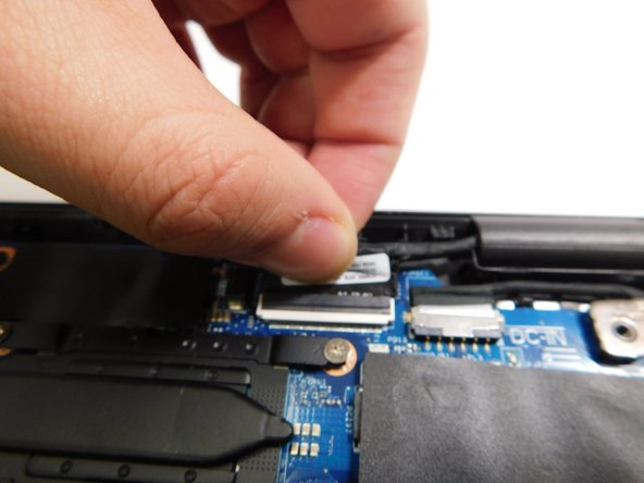

    • Start by unplugging the cable for display.
  5. Dell Vostro 3510 Display Replacement: crwdns2935265:05crwdnd2935265:01crwdnd2935265:03crwdne2935265:0 Dell Vostro 3510 Display Replacement: crwdns2935265:05crwdnd2935265:02crwdnd2935265:03crwdne2935265:0 Dell Vostro 3510 Display Replacement: crwdns2935265:05crwdnd2935265:03crwdnd2935265:03crwdne2935265:0
    • Remove the 1 mm screws in red circle with Phillips #0 screwdriver.
  6. Dell Vostro 3510 Display Replacement: crwdns2935265:06crwdnd2935265:01crwdnd2935265:02crwdne2935265:0 Dell Vostro 3510 Display Replacement: crwdns2935265:06crwdnd2935265:02crwdnd2935265:02crwdne2935265:0
    • Remove the 1 mm screws holding down the metal bracket in red circle with Phillips #0 screwdriver.
  7. Dell Vostro 3510 Display Replacement: crwdns2935265:07crwdnd2935265:01crwdnd2935265:02crwdne2935265:0 Dell Vostro 3510 Display Replacement: crwdns2935265:07crwdnd2935265:02crwdnd2935265:02crwdne2935265:0
    • Unplug both the white and black wire
    • The black wire is marked in red.
    • The white wire is marked in orange.
