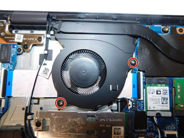

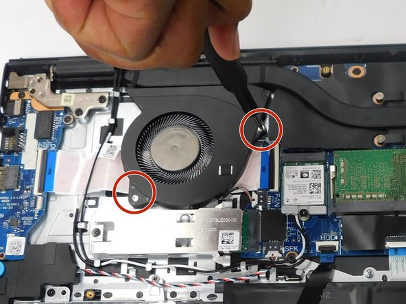

  4. Dell Vostro 3510 CPU Fan Replacement: crwdns2935265:04crwdnd2935265:01crwdnd2935265:01crwdne2935265:0
    • Remove the battery cable from the motherboard by lightly pulling on the black tape attached to the ribbon cable.
  5. Dell Vostro 3510 CPU Fan Replacement: crwdns2935265:05crwdnd2935265:01crwdnd2935265:03crwdne2935265:0 Dell Vostro 3510 CPU Fan Replacement: crwdns2935265:05crwdnd2935265:02crwdnd2935265:03crwdne2935265:0 Dell Vostro 3510 CPU Fan Replacement: crwdns2935265:05crwdnd2935265:03crwdnd2935265:03crwdne2935265:0
    • Use a Phillips #0 screwdriver to remove the two 1 mm screws that secure the CPU fan.
  6. Dell Vostro 3510 CPU Fan Replacement: crwdns2935265:06crwdnd2935265:01crwdnd2935265:02crwdne2935265:0 Dell Vostro 3510 CPU Fan Replacement: crwdns2935265:06crwdnd2935265:02crwdnd2935265:02crwdne2935265:0
    • Gently pull the fan cable out of its socket.
    • Safely remove the CPU fan.
