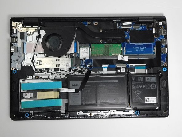

    • Use a Phillips #0 screwdriver to remove the screws highlighted with red circles.
    • Loosen the two 1 mm captive screws (orange circles in the image) on the back corners of the bottom cover.
    • Keep track of each screw and make sure it goes back exactly where it came from to avoid damaging your laptop.
  3. Dell Vostro 3510 Battery Replacement: crwdns2935265:03crwdnd2935265:01crwdnd2935265:02crwdne2935265:0 Dell Vostro 3510 Battery Replacement: crwdns2935265:03crwdnd2935265:02crwdnd2935265:02crwdne2935265:0
    • Open up the back cover of the laptop.
    • It is much easier to open up the laptop with any type of spudger or with Jimmy.
  4. Dell Vostro 3510 Battery Replacement: crwdns2935265:04crwdnd2935265:01crwdnd2935265:02crwdne2935265:0 Dell Vostro 3510 Battery Replacement: crwdns2935265:04crwdnd2935265:02crwdnd2935265:02crwdne2935265:0
    • Remove the battery cable from the motherboard by lightly pulling on the black tape attached to the ribbon cable.
  5. Dell Vostro 3510 Battery Replacement: crwdns2935265:05crwdnd2935265:01crwdnd2935265:01crwdne2935265:0
    • Use a Phillips #0 screwdriver to remove the three battery screws.
    • Carefully move the additional sata storage ribbon cable to the side.
  6. Dell Vostro 3510 Battery Replacement: crwdns2935265:06crwdnd2935265:01crwdnd2935265:01crwdne2935265:0
    • Gently remove the battery from the laptop.
    • Be careful with the other ribbon cables.
