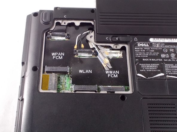

  2. Dell Vostro 1700 Wi-Fi Card Replacement: crwdns2935265:02crwdnd2935265:01crwdnd2935265:03crwdne2935265:0 Dell Vostro 1700 Wi-Fi Card Replacement: crwdns2935265:02crwdnd2935265:02crwdnd2935265:03crwdne2935265:0 Dell Vostro 1700 Wi-Fi Card Replacement: crwdns2935265:02crwdnd2935265:03crwdnd2935265:03crwdne2935265:0
    • Lift up on the cover and remove it.

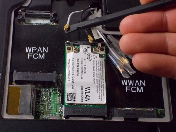

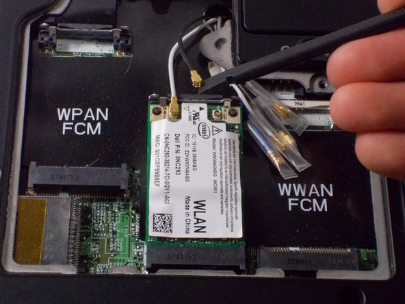

  3. Dell Vostro 1700 Wi-Fi Card Replacement: crwdns2935265:03crwdnd2935265:01crwdnd2935265:03crwdne2935265:0 Dell Vostro 1700 Wi-Fi Card Replacement: crwdns2935265:03crwdnd2935265:02crwdnd2935265:03crwdne2935265:0 Dell Vostro 1700 Wi-Fi Card Replacement: crwdns2935265:03crwdnd2935265:03crwdnd2935265:03crwdne2935265:0
    • Use the spudger to lift the small wires connecting to the Wi-Fi card.

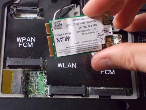

  5. Dell Vostro 1700 Wi-Fi Card Replacement: crwdns2935265:05crwdnd2935265:01crwdnd2935265:03crwdne2935265:0 Dell Vostro 1700 Wi-Fi Card Replacement: crwdns2935265:05crwdnd2935265:02crwdnd2935265:03crwdne2935265:0 Dell Vostro 1700 Wi-Fi Card Replacement: crwdns2935265:05crwdnd2935265:03crwdnd2935265:03crwdne2935265:0
    • Pull the card outward and then upward to remove it from the slot.
