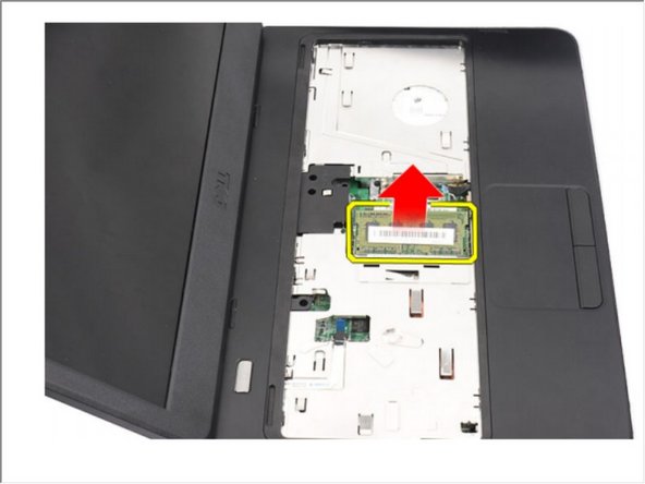

  3. Dell Vostro 1450 Memory Module Replacement, KeyBoard: crwdns2935265:03crwdnd2935265:01crwdnd2935265:01crwdne2935265:0
    • Pry up to release the top four snaps securing the keyboard to the computer.
  4. Dell Vostro 1450 Memory Module Replacement: crwdns2935265:04crwdnd2935265:01crwdnd2935265:01crwdne2935265:0
    • Flip the keyboard over and lay it on the palm rest.
  5. Dell Vostro 1450 Memory Module Replacement: crwdns2935265:05crwdnd2935265:01crwdnd2935265:01crwdne2935265:0
    • Disconnect the keyboard cable from the system board.
  6. Dell Vostro 1450 Memory Module Replacement: crwdns2935265:06crwdnd2935265:01crwdnd2935265:01crwdne2935265:0
    • Remove the keyboard from the computer.
  7. Dell Vostro 1450 Memory Module Replacement, Memory Module: crwdns2935265:07crwdnd2935265:01crwdnd2935265:02crwdne2935265:0 Dell Vostro 1450 Memory Module Replacement, Memory Module: crwdns2935265:07crwdnd2935265:02crwdnd2935265:02crwdne2935265:0
    • Pry the retention clips away from the memory module until it pops up.
    • Remove the memory module from the computer.
