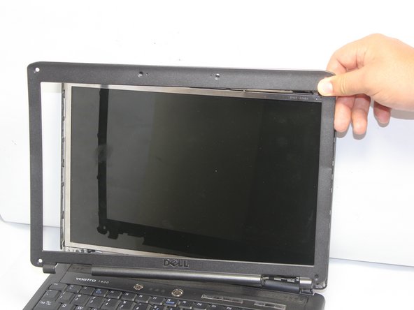

  6. Dell Vostro 1400 Screen Replacement: crwdns2935265:06crwdnd2935265:01crwdnd2935265:02crwdne2935265:0 Dell Vostro 1400 Screen Replacement: crwdns2935265:06crwdnd2935265:02crwdnd2935265:02crwdne2935265:0
    • Carefully remove the plastic surrounding the screen by pulling off, starting at the bottom.
    • Remove the two (2.5mm x 5mm) screws at the top, by the camera.

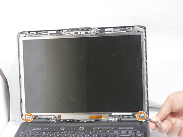

  7. Dell Vostro 1400 Screen Replacement: crwdns2935265:07crwdnd2935265:01crwdnd2935265:02crwdne2935265:0 Dell Vostro 1400 Screen Replacement: crwdns2935265:07crwdnd2935265:02crwdnd2935265:02crwdne2935265:0
    • Remove the two 5mm screws from the camera above the screen.
    • Remove the two 5mm screws from the bottom of the screen.
  8. Dell Vostro 1400 Screen Replacement: crwdns2935265:08crwdnd2935265:01crwdnd2935265:02crwdne2935265:0 Dell Vostro 1400 Screen Replacement: crwdns2935265:08crwdnd2935265:02crwdnd2935265:02crwdne2935265:0
    • Carefully remove the screen from the back cover.
