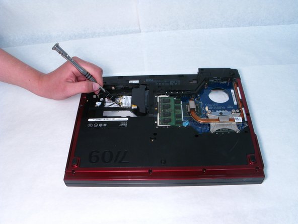

    • Remove all visible screws from the bottom of the computer.
  3. Dell Vostro 1320 USB Port Replacement: crwdns2935265:03crwdnd2935265:01crwdnd2935265:03crwdne2935265:0 Dell Vostro 1320 USB Port Replacement: crwdns2935265:03crwdnd2935265:02crwdnd2935265:03crwdne2935265:0 Dell Vostro 1320 USB Port Replacement: crwdns2935265:03crwdnd2935265:03crwdnd2935265:03crwdne2935265:0

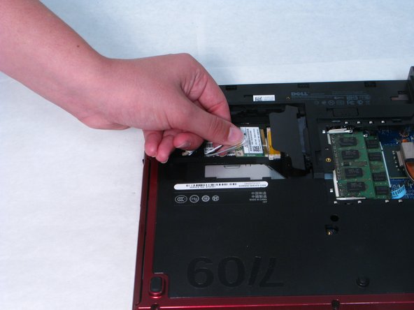

    • Use a metal spudger to remover the covers of each section that you removed screws from.
    • Once the cover is removed from the hard drive remove the hard drive by gently tugging it out.

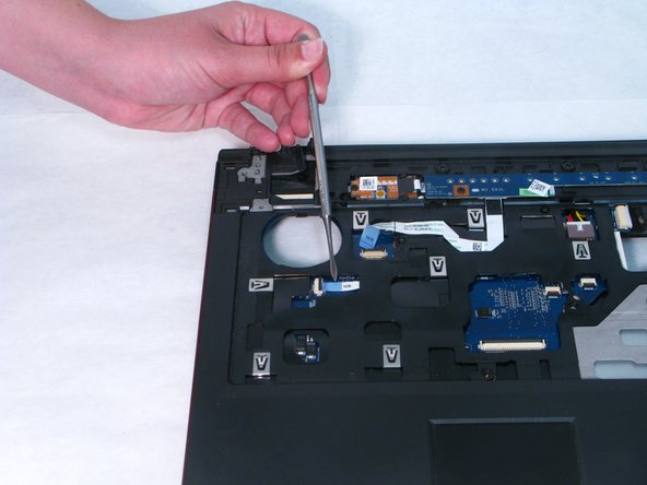

    • You must first unscrew the screws holding the wire in place.
    • Unhook the wire that the metal spudger is pointing at.

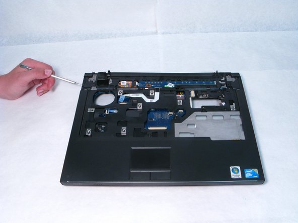

    • Detach the black plastic cover by loosening it with a metal spudger.
  11. Dell Vostro 1320 USB Port Replacement: crwdns2935265:011crwdnd2935265:01crwdnd2935265:01crwdne2935265:0
    • Unplug the wire that the metal spudger is pointing to.

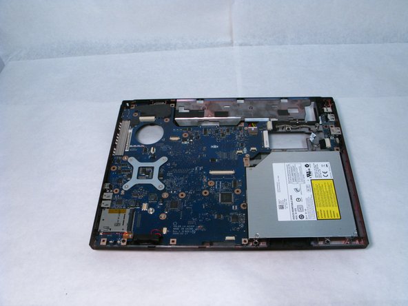

    • Unscrew the USB port.
  13. Dell Vostro 1320 USB Port Replacement: crwdns2935265:013crwdnd2935265:01crwdnd2935265:02crwdne2935265:0 Dell Vostro 1320 USB Port Replacement: crwdns2935265:013crwdnd2935265:02crwdnd2935265:02crwdne2935265:0
    • Gently lift out the USB port.
