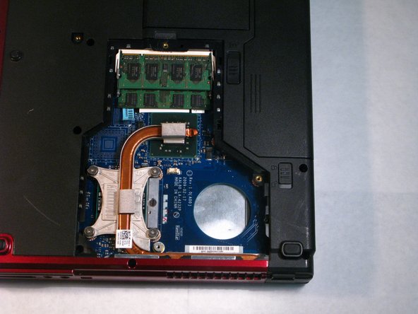

    • Unplug the wire connecting the fan to the computer by pulling straight up on the connector.
  4. Dell Vostro 1320 Fan Replacement: crwdns2935265:04crwdnd2935265:01crwdnd2935265:02crwdne2935265:0 Dell Vostro 1320 Fan Replacement: crwdns2935265:04crwdnd2935265:02crwdnd2935265:02crwdne2935265:0
    • Remove the two black screws holding the fan down by using the phillips head screwdriver.
  5. Dell Vostro 1320 Fan Replacement: crwdns2935265:05crwdnd2935265:01crwdnd2935265:02crwdne2935265:0 Dell Vostro 1320 Fan Replacement: crwdns2935265:05crwdnd2935265:02crwdnd2935265:02crwdne2935265:0
    • Gently pull the fan away from the side of the computer. Lift it out completely.
    • At this point you can now blow all the dust out of your fan and the copper heatsink.
