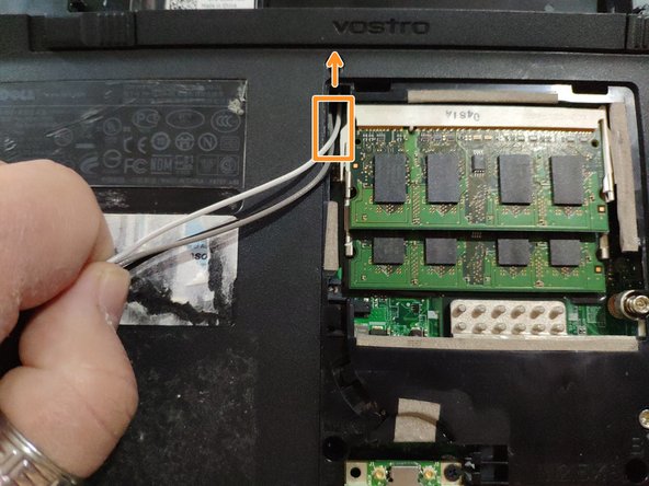

  6. Dell Vostro 1220 Hard Drive Replacement, Unplug the WiFi card: crwdns2935265:06crwdnd2935265:01crwdnd2935265:03crwdne2935265:0 Dell Vostro 1220 Hard Drive Replacement, Unplug the WiFi card: crwdns2935265:06crwdnd2935265:02crwdnd2935265:03crwdne2935265:0 Dell Vostro 1220 Hard Drive Replacement, Unplug the WiFi card: crwdns2935265:06crwdnd2935265:03crwdnd2935265:03crwdne2935265:0
    • In order to disconnect the WiFi card, we will open the door by unscrewing two screws and unclipping the cover.
    • We then remove the two connectors from the Wi-Fi card.
    • Finally, we remove the cables from the front of the laptop (the Wi-Fi card is located behind the laptop but the antenna is located in the screen).

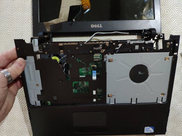

  9. Dell Vostro 1220 Hard Drive Replacement, Remove the upper part of the shell: crwdns2935265:09crwdnd2935265:01crwdnd2935265:02crwdne2935265:0 Dell Vostro 1220 Hard Drive Replacement, Remove the upper part of the shell: crwdns2935265:09crwdnd2935265:02crwdnd2935265:02crwdne2935265:0
    • The upper part of the shell is removed by sliding down.
    • We will first unclip both sides and the top, then we will slide the shell down

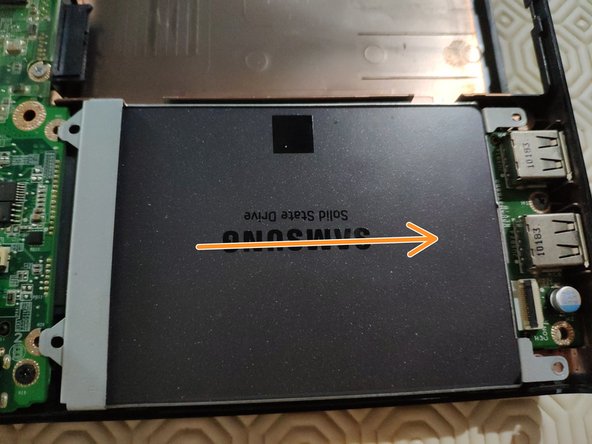

  10. Dell Vostro 1220 Hard Drive Replacement, Detach the hard drive cage: crwdns2935265:010crwdnd2935265:01crwdnd2935265:02crwdne2935265:0 Dell Vostro 1220 Hard Drive Replacement, Detach the hard drive cage: crwdns2935265:010crwdnd2935265:02crwdnd2935265:02crwdne2935265:0
    • We will unscrew the hard drive cage as well as the tablecloth.
    • Then we slide the cage to the right.
