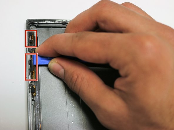

  11. Dell Venue 8 7840 Power and Volume Button Replacement, Power and Volume Button: crwdns2935265:011crwdnd2935265:01crwdnd2935265:02crwdne2935265:0 Dell Venue 8 7840 Power and Volume Button Replacement, Power and Volume Button: crwdns2935265:011crwdnd2935265:02crwdnd2935265:02crwdne2935265:0
    • Using a plastic opening tool, pry open the left side of the tablet.
    • Locate the power and volume buttons.
  12. Dell Venue 8 7840 Power and Volume Button Replacement: crwdns2935265:012crwdnd2935265:01crwdnd2935265:01crwdne2935265:0
    • Using a plastic opening tool, push out the volume button from the left side of the tablet.
  13. Dell Venue 8 7840 Power and Volume Button Replacement: crwdns2935265:013crwdnd2935265:01crwdnd2935265:01crwdne2935265:0
    • Make sure that you hold the left side of the tablet open with a plastic opening tool so that you will be able to take out the volume button.
    • With tweezers, pull out the volume button.
  14. Dell Venue 8 7840 Power and Volume Button Replacement: crwdns2935265:014crwdnd2935265:01crwdnd2935265:01crwdne2935265:0
    • With a plastic opening tool, push out the power button from the left side of the tablet.
  15. Dell Venue 8 7840 Power and Volume Button Replacement: crwdns2935265:015crwdnd2935265:01crwdnd2935265:01crwdne2935265:0
    • Just like the volume button, you want to make sure that you hold the left side of the tablet open with a plastic opening tool so that you will be able to take out the power button.
    • With tweezers, pull out the power button.
