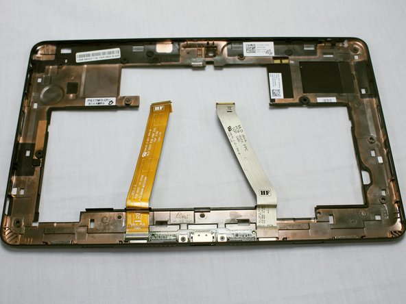

    • Slide the cover on the two middle ribbon cables out to remove it. It should uncover the orange cable connectors.
  5. Dell Venue 11 Pro LCD Screen Replacement: crwdns2935265:05crwdnd2935265:01crwdnd2935265:03crwdne2935265:0 Dell Venue 11 Pro LCD Screen Replacement: crwdns2935265:05crwdnd2935265:02crwdnd2935265:03crwdne2935265:0 Dell Venue 11 Pro LCD Screen Replacement: crwdns2935265:05crwdnd2935265:03crwdnd2935265:03crwdne2935265:0
    • To disconnect the left ribbon cable from the motherboard, place the flat end of your spudger under the edge of the pop connector and pry the connector straight up.
    • The two ribbon cables connect the keyboard attachment ports to the motherboard. Damage to either cables can induce problems with the Dell mobile keyboard.

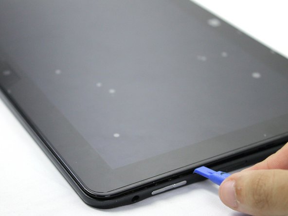

  9. Dell Venue 11 Pro LCD Screen Replacement: crwdns2935265:09crwdnd2935265:01crwdnd2935265:03crwdne2935265:0 Dell Venue 11 Pro LCD Screen Replacement: crwdns2935265:09crwdnd2935265:02crwdnd2935265:03crwdne2935265:0 Dell Venue 11 Pro LCD Screen Replacement: crwdns2935265:09crwdnd2935265:03crwdnd2935265:03crwdne2935265:0
    • Insert your plastic opening tool between the screen and frame, and run the tool around the edges to separate the frame from the tablet.

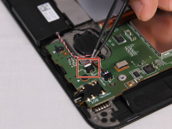

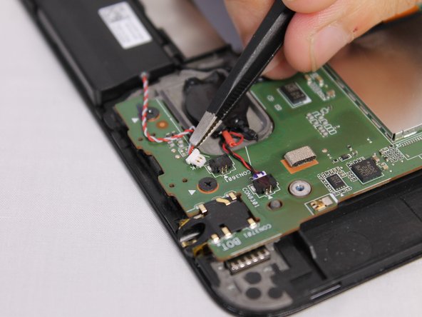

  14. Dell Venue 11 Pro LCD Screen Replacement: crwdns2935265:014crwdnd2935265:01crwdnd2935265:03crwdne2935265:0 Dell Venue 11 Pro LCD Screen Replacement: crwdns2935265:014crwdnd2935265:02crwdnd2935265:03crwdne2935265:0 Dell Venue 11 Pro LCD Screen Replacement: crwdns2935265:014crwdnd2935265:03crwdnd2935265:03crwdne2935265:0
    • Using a pair of tweezers, detach the red and white cable connector from the circuit board.
    • The laptop is rotated 130 degrees counterclockwise for better viewing.
  15. Dell Venue 11 Pro LCD Screen Replacement: crwdns2935265:015crwdnd2935265:01crwdnd2935265:02crwdne2935265:0 Dell Venue 11 Pro LCD Screen Replacement: crwdns2935265:015crwdnd2935265:02crwdnd2935265:02crwdne2935265:0
    • Once the cable has been detached, use your fingers to lift the right speaker upwards to remove it.

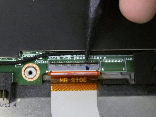

    • Start by removing the top ZIF USB ribbon connector
    • If you are replacing the motherboard by itself, then skip steps 23, 24, and 25.
  19. Dell Venue 11 Pro LCD Screen Replacement: crwdns2935265:019crwdnd2935265:01crwdnd2935265:03crwdne2935265:0 Dell Venue 11 Pro LCD Screen Replacement: crwdns2935265:019crwdnd2935265:02crwdnd2935265:03crwdne2935265:0 Dell Venue 11 Pro LCD Screen Replacement: crwdns2935265:019crwdnd2935265:03crwdnd2935265:03crwdne2935265:0
    • To remove the ribbon cable, move the black retainer upwards. Then pull the ribbon cable rearwards to remove it.

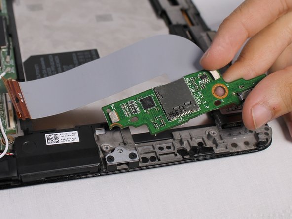

  23. Dell Venue 11 Pro LCD Screen Replacement: crwdns2935265:023crwdnd2935265:01crwdnd2935265:02crwdne2935265:0 Dell Venue 11 Pro LCD Screen Replacement: crwdns2935265:023crwdnd2935265:02crwdnd2935265:02crwdne2935265:0
    • After disconnecting all the pieces, remove the USB port circuit board with your fingers

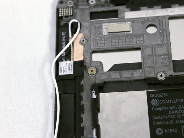

    • Now remove the white coaxial connector using the tweezers to pull the connector upwards.
  32. Dell Venue 11 Pro LCD Screen Replacement: crwdns2935265:032crwdnd2935265:01crwdnd2935265:02crwdne2935265:0 Dell Venue 11 Pro LCD Screen Replacement: crwdns2935265:032crwdnd2935265:02crwdnd2935265:02crwdne2935265:0
    • Next simply move the white wire away from the motherboard using your fingers.

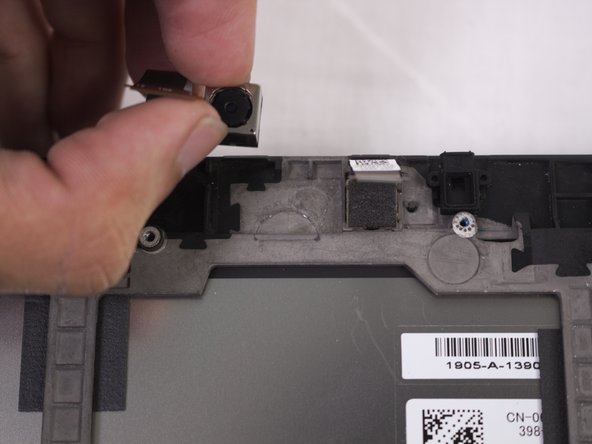

    • Now we turn our attention to the backside webcam on the top portion of the shell.
  38. Dell Venue 11 Pro LCD Screen Replacement: crwdns2935265:038crwdnd2935265:01crwdnd2935265:03crwdne2935265:0 Dell Venue 11 Pro LCD Screen Replacement: crwdns2935265:038crwdnd2935265:02crwdnd2935265:03crwdne2935265:0 Dell Venue 11 Pro LCD Screen Replacement: crwdns2935265:038crwdnd2935265:03crwdnd2935265:03crwdne2935265:0
    • Lift the back side camera with your fingers.
  39. Dell Venue 11 Pro LCD Screen Replacement: crwdns2935265:039crwdnd2935265:01crwdnd2935265:03crwdne2935265:0 Dell Venue 11 Pro LCD Screen Replacement: crwdns2935265:039crwdnd2935265:02crwdnd2935265:03crwdne2935265:0 Dell Venue 11 Pro LCD Screen Replacement: crwdns2935265:039crwdnd2935265:03crwdnd2935265:03crwdne2935265:0

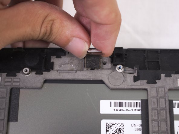

    • Lift the front side camera with your fingers.
  40. Dell Venue 11 Pro LCD Screen Replacement: crwdns2935265:040crwdnd2935265:01crwdnd2935265:02crwdne2935265:0 Dell Venue 11 Pro LCD Screen Replacement: crwdns2935265:040crwdnd2935265:02crwdnd2935265:02crwdne2935265:0
    • Take caution when removing the front camera with the rubber cover. The cover can easily fall off from any slight movement.

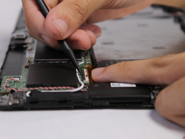

    • Now we turn our attention to the bottom right hand side of the back where the ribbon is secured in place.
    • Using the sharp end of the plastic spudger, lift the ZIF lock to release the ribbon and pull rearwards to separate.

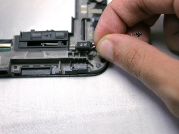

    • Locate the vibration motor at the bottom right corner of the screen shell. Grab the motor by the cable and pull upwards to remove.

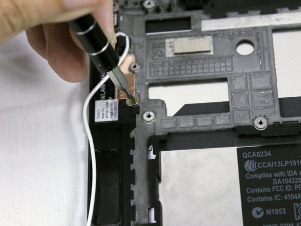

  44. Dell Venue 11 Pro LCD Screen Replacement: crwdns2935265:044crwdnd2935265:01crwdnd2935265:03crwdne2935265:0 Dell Venue 11 Pro LCD Screen Replacement: crwdns2935265:044crwdnd2935265:02crwdnd2935265:03crwdne2935265:0 Dell Venue 11 Pro LCD Screen Replacement: crwdns2935265:044crwdnd2935265:03crwdnd2935265:03crwdne2935265:0
    • The final step is to remove the 2.5 mm bronze screw using a Philips #000 screwdriver.
