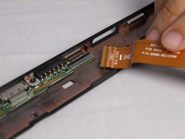

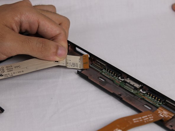

    • Next, you need to remove the two ribbon cables located at the bottom of the frame. To detach the first ribbon cable you need to pull straight up on the orange connecter.
  11. Dell Venue 11 Pro Keyboard Port Replacement: crwdns2935265:011crwdnd2935265:01crwdnd2935265:02crwdne2935265:0 Dell Venue 11 Pro Keyboard Port Replacement: crwdns2935265:011crwdnd2935265:02crwdnd2935265:02crwdne2935265:0

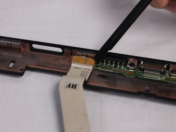

    • To remove the second ribbon cable you must first raise a black retainer with a thin plastic tool. Then you must pull the cable down to free it from the frame.

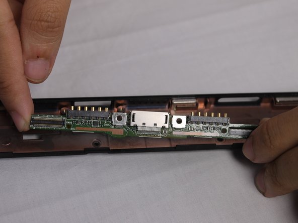

    • Now you must remove two 2.5mm screws that are securing the keyboard port to the frame. When removing the screws use the Phillips #000 bit.
  13. Dell Venue 11 Pro Keyboard Port Replacement: crwdns2935265:013crwdnd2935265:01crwdnd2935265:02crwdne2935265:0 Dell Venue 11 Pro Keyboard Port Replacement: crwdns2935265:013crwdnd2935265:02crwdnd2935265:02crwdne2935265:0
    • The final step is to lift the keyboard port free from the frame using your fingers.
