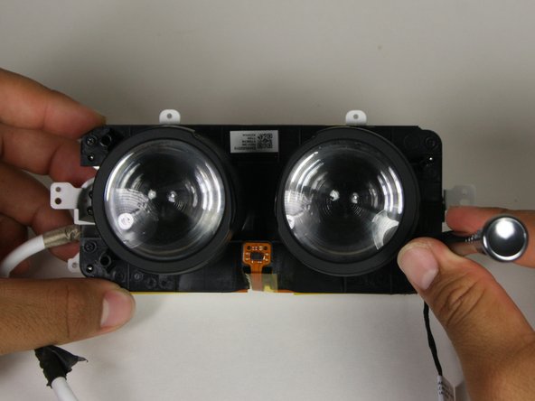

    4. Dell VRP100 Screen Replacement: crwdns2935265:04crwdnd2935265:01crwdnd2935265:03crwdne2935265:0 Dell VRP100 Screen Replacement: crwdns2935265:04crwdnd2935265:02crwdnd2935265:03crwdne2935265:0 Dell VRP100 Screen Replacement: crwdns2935265:04crwdnd2935265:03crwdnd2935265:03crwdne2935265:0
      • Remove the six 5.5mm PH000 screws from the cover by rotating counter-clockwise.
      • Carefully remove the lens and motherboard assembly from the white casing.

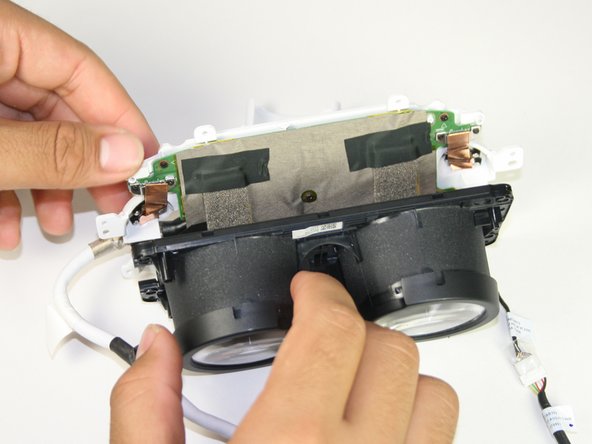

    1. Dell VRP100 Screen Replacement, Screen: crwdns2935265:05crwdnd2935265:01crwdnd2935265:03crwdne2935265:0 Dell VRP100 Screen Replacement, Screen: crwdns2935265:05crwdnd2935265:02crwdnd2935265:03crwdne2935265:0 Dell VRP100 Screen Replacement, Screen: crwdns2935265:05crwdnd2935265:03crwdnd2935265:03crwdne2935265:0
      • Remove the four 2.5 mm PH000 screws by rotating counter-clockwise.
      • Separate the lenses from the motherboard panel.

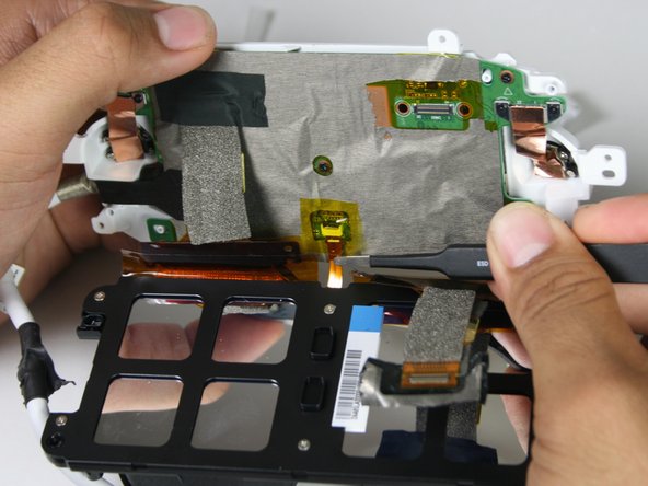

    2. Dell VRP100 Screen Replacement: crwdns2935265:06crwdnd2935265:01crwdnd2935265:02crwdne2935265:0 Dell VRP100 Screen Replacement: crwdns2935265:06crwdnd2935265:02crwdnd2935265:02crwdne2935265:0
      • Take off the tape using the blunt nosed tweezers to disconnect the flat-topped connector from the motherboard.
      • The screen is attached to the motherboard using an adhesive.

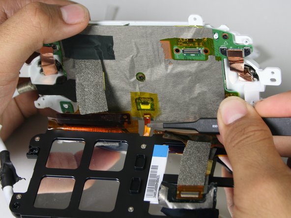

    3. Dell VRP100 Screen Replacement: crwdns2935265:07crwdnd2935265:01crwdnd2935265:03crwdne2935265:0 Dell VRP100 Screen Replacement: crwdns2935265:07crwdnd2935265:02crwdnd2935265:03crwdne2935265:0 Dell VRP100 Screen Replacement: crwdns2935265:07crwdnd2935265:03crwdnd2935265:03crwdne2935265:0
      • Lift the yellow tape with tweezers.
      • Remove the ribbon cable from the screen to the motherboard with tweezers.

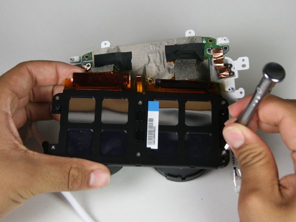

    4. Dell VRP100 Screen Replacement: crwdns2935265:08crwdnd2935265:01crwdnd2935265:03crwdne2935265:0 Dell VRP100 Screen Replacement: crwdns2935265:08crwdnd2935265:02crwdnd2935265:03crwdne2935265:0 Dell VRP100 Screen Replacement: crwdns2935265:08crwdnd2935265:03crwdnd2935265:03crwdne2935265:0
      • Remove the six 3.4mm PH000 screws by rotating counter-clockwise connecting the back panel to the screen.
      • Remove the back panel from the screen by carefully pulling apart the two.

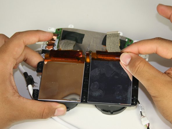

    5. Dell VRP100 Screen Replacement: crwdns2935265:09crwdnd2935265:01crwdnd2935265:03crwdne2935265:0 Dell VRP100 Screen Replacement: crwdns2935265:09crwdnd2935265:02crwdnd2935265:03crwdne2935265:0 Dell VRP100 Screen Replacement: crwdns2935265:09crwdnd2935265:03crwdnd2935265:03crwdne2935265:0
      • Peel away the screen with both hands.
      • A plastic opening tool may be required for removing the screen.
      • Adhesive may need to be reapplied during the rebuild.
