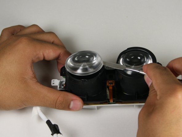

    1. Dell VRP100 Lens Replacement, Lens: crwdns2935265:05crwdnd2935265:01crwdnd2935265:02crwdne2935265:0 Dell VRP100 Lens Replacement, Lens: crwdns2935265:05crwdnd2935265:02crwdnd2935265:02crwdne2935265:0
      • Deattach the black cover from the lens with a metal spudger.
      • This will “click” back into place during replacement.

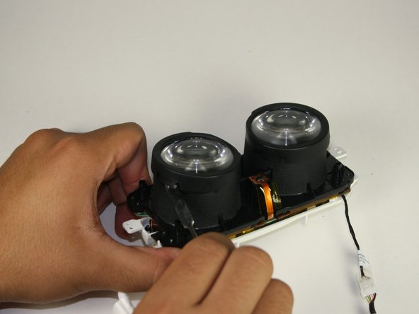

    2. Dell VRP100 Lens Replacement: crwdns2935265:06crwdnd2935265:01crwdnd2935265:03crwdne2935265:0 Dell VRP100 Lens Replacement: crwdns2935265:06crwdnd2935265:02crwdnd2935265:03crwdne2935265:0 Dell VRP100 Lens Replacement: crwdns2935265:06crwdnd2935265:03crwdnd2935265:03crwdne2935265:0
      • Gently insert the metal spudger between the lens and the lens casing.
      • Rotate the spudger around the exterior of the lens and lens housing, separating them.
      • The lens is held in place with an adhesive that will have to be applied during reassembly.

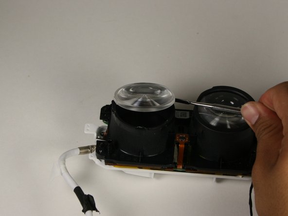

    3. Dell VRP100 Lens Replacement: crwdns2935265:07crwdnd2935265:01crwdnd2935265:01crwdne2935265:0
      • Holding the lens around the outside, gently lift it out of its housing.
