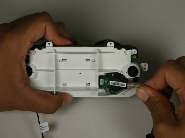

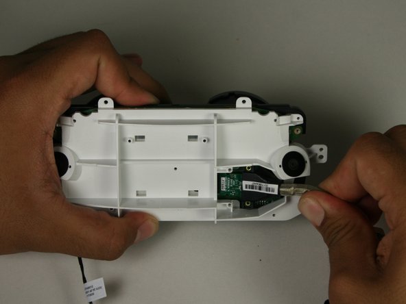

    1. Dell VRP100 HDMI/USB Cable Replacement, HDMI/USB Cable: crwdns2935265:05crwdnd2935265:01crwdnd2935265:02crwdne2935265:0 Dell VRP100 HDMI/USB Cable Replacement, HDMI/USB Cable: crwdns2935265:05crwdnd2935265:02crwdnd2935265:02crwdne2935265:0
      • Remove the two 3.4mm PH000 screws from the cover by rotating counter-clockwise.
      • Peel off the tape using your hands or the blunt nose tweezers.
    2. Dell VRP100 HDMI/USB Cable Replacement: crwdns2935265:06crwdnd2935265:01crwdnd2935265:03crwdne2935265:0 Dell VRP100 HDMI/USB Cable Replacement: crwdns2935265:06crwdnd2935265:02crwdnd2935265:03crwdne2935265:0 Dell VRP100 HDMI/USB Cable Replacement: crwdns2935265:06crwdnd2935265:03crwdnd2935265:03crwdne2935265:0
      • Remove the two 5.5mm PH000 screws from the cover by rotating counter-clockwise.
      • Hold the HDMI/USB cable and remove from the connection.
