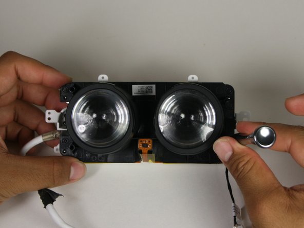

    • Remove the six 5.5mm PH000 screws from the cover by rotating counter-clockwise.
    • Carefully remove the lens and motherboard assembly from the white casing.
  5. Dell VRP100 Camera Replacement, Camera: crwdns2935265:05crwdnd2935265:01crwdnd2935265:03crwdne2935265:0 Dell VRP100 Camera Replacement, Camera: crwdns2935265:05crwdnd2935265:02crwdnd2935265:03crwdne2935265:0 Dell VRP100 Camera Replacement, Camera: crwdns2935265:05crwdnd2935265:03crwdnd2935265:03crwdne2935265:0
    • Remove the four 2.5mm PH000 screws by rotating counter-clockwise.
    • Separate the lens housing from the motherboard panel.

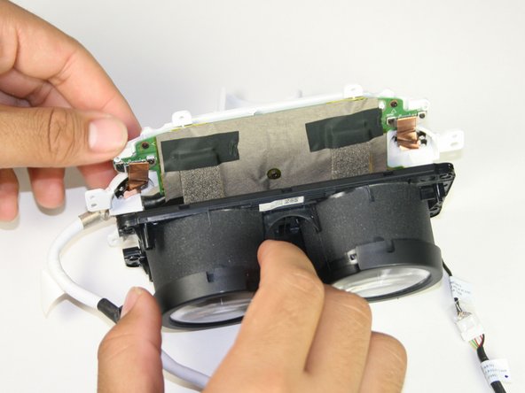

  6. Dell VRP100 Camera Replacement: crwdns2935265:06crwdnd2935265:01crwdnd2935265:02crwdne2935265:0 Dell VRP100 Camera Replacement: crwdns2935265:06crwdnd2935265:02crwdnd2935265:02crwdne2935265:0
    • Remove the two 2.5mm PH000 screws from the motherboard by rotating counter-clockwise.
    • Remove the four 3.9mm PH000 screws from the white casing by rotating counter-clockwise.

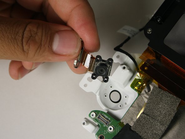

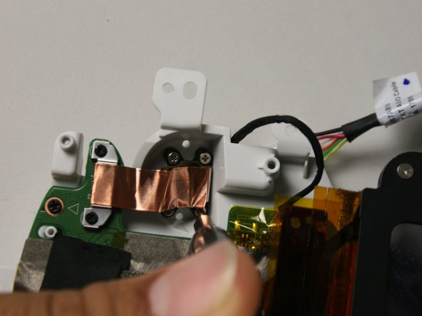

  7. Dell VRP100 Camera Replacement: crwdns2935265:07crwdnd2935265:01crwdnd2935265:02crwdne2935265:0 Dell VRP100 Camera Replacement: crwdns2935265:07crwdnd2935265:02crwdnd2935265:02crwdne2935265:0
    • Remove the flat-topped connector by lifting it straight up from the motherboard.
    • Carefully remove the camera from the casing with the blunt nose tweezers by holding onto the copper tape.
    • To reinstall, line up the connectors and firmly push until you hear a pop.
