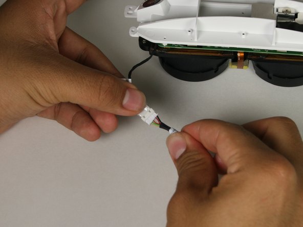

  5. Dell VRP100 Auxiliary Cord Replacement, Auxiliary Cord: crwdns2935265:05crwdnd2935265:01crwdnd2935265:03crwdne2935265:0 Dell VRP100 Auxiliary Cord Replacement, Auxiliary Cord: crwdns2935265:05crwdnd2935265:02crwdnd2935265:03crwdne2935265:0 Dell VRP100 Auxiliary Cord Replacement, Auxiliary Cord: crwdns2935265:05crwdnd2935265:03crwdnd2935265:03crwdne2935265:0
    • Separate the external connector of the auxiliary cord.
    • A spudger may be needed to separate the connector.

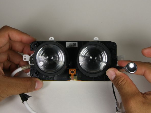

  6. Dell VRP100 Auxiliary Cord Replacement: crwdns2935265:06crwdnd2935265:01crwdnd2935265:02crwdne2935265:0 Dell VRP100 Auxiliary Cord Replacement: crwdns2935265:06crwdnd2935265:02crwdnd2935265:02crwdne2935265:0
    • Remove the four 2.5mm PH000 screws by rotating counter-clockwise.
    • Separate the lens housing from the motherboard panel.

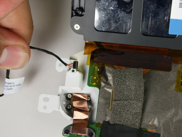

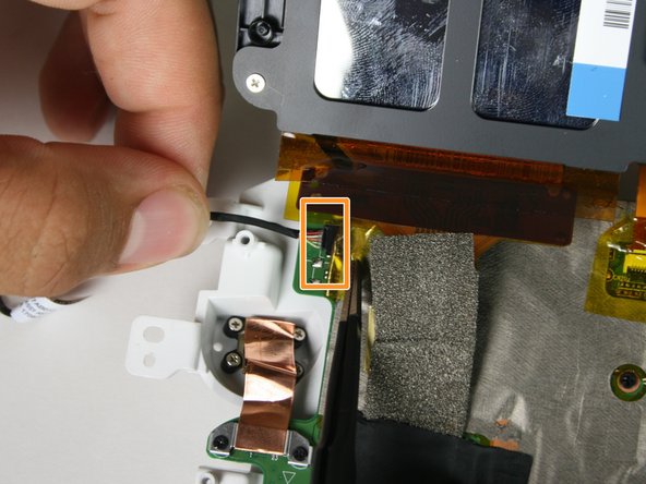

  7. Dell VRP100 Auxiliary Cord Replacement: crwdns2935265:07crwdnd2935265:01crwdnd2935265:03crwdne2935265:0 Dell VRP100 Auxiliary Cord Replacement: crwdns2935265:07crwdnd2935265:02crwdnd2935265:03crwdne2935265:0 Dell VRP100 Auxiliary Cord Replacement: crwdns2935265:07crwdnd2935265:03crwdnd2935265:03crwdne2935265:0
    • In the top right corner of the motherboard panel, peel back the yellow tape covering the bundled auxiliary cable connector using tweezers.
    • Carefully pull out the bundled cable connectors.
