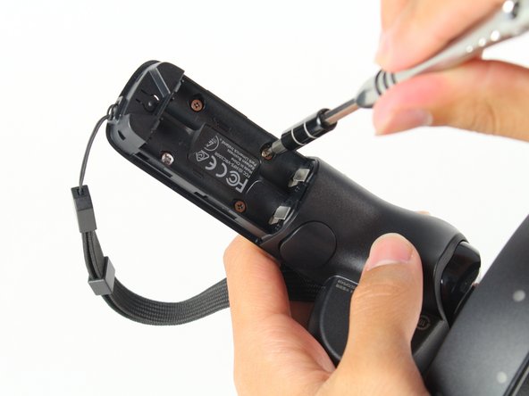

    • Orient your controller so that the black ring is on the bottom and the buttons are facing away from yourself.
    • Place your thumb on the small arrow that is on the controller's battery cover and firmly push upwards.
    • Slide the cover off and separate it from the controller.
  2. Dell VRC100-R Touchpad Replacement: crwdns2935265:02crwdnd2935265:01crwdnd2935265:02crwdne2935265:0 Dell VRC100-R Touchpad Replacement: crwdns2935265:02crwdnd2935265:02crwdnd2935265:02crwdne2935265:0
    • Remove the right battery by pushing the positive end down and pulling the battery out toward yourself.
    • Repeat the procedure for the left battery.

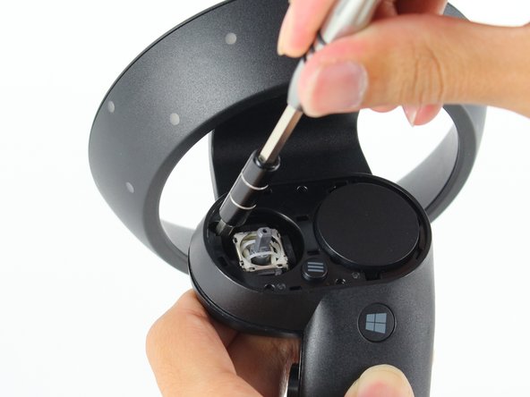

  3. Dell VRC100-R Touchpad Replacement, Joystick: crwdns2935265:03crwdnd2935265:01crwdnd2935265:03crwdne2935265:0 Dell VRC100-R Touchpad Replacement, Joystick: crwdns2935265:03crwdnd2935265:02crwdnd2935265:03crwdne2935265:0 Dell VRC100-R Touchpad Replacement, Joystick: crwdns2935265:03crwdnd2935265:03crwdnd2935265:03crwdne2935265:0
    • Hold the joystick down with your left thumb to make space for the plastic opening tool.
    • Insert the plastic opening tool into the circle above the joystick and pry upwards to lift the front panel.
    • Slide the plastic opening tool around the perimeter until you can lift the front panel.
    • You may hear a popping noise when you pry off the front panel.
  4. Dell VRC100-R Touchpad Replacement: crwdns2935265:04crwdnd2935265:01crwdnd2935265:02crwdne2935265:0 Dell VRC100-R Touchpad Replacement: crwdns2935265:04crwdnd2935265:02crwdnd2935265:02crwdne2935265:0
    • Grab the joystick and pull away from the controller to remove it.
  5. Dell VRC100-R Touchpad Replacement, Touchpad: crwdns2935265:05crwdnd2935265:01crwdnd2935265:02crwdne2935265:0 Dell VRC100-R Touchpad Replacement, Touchpad: crwdns2935265:05crwdnd2935265:02crwdnd2935265:02crwdne2935265:0

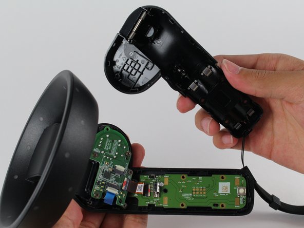

    • Turn your controller over and orient it so that the thin side is on the top.
    • Remove four 4mm Phillips #0 screws.
  7. Dell VRC100-R Touchpad Replacement: crwdns2935265:07crwdnd2935265:01crwdnd2935265:02crwdne2935265:0 Dell VRC100-R Touchpad Replacement: crwdns2935265:07crwdnd2935265:02crwdnd2935265:02crwdne2935265:0
    • Turn your controller 90 degrees clockwise and insert a plastic opening tool into the crease of the back panel.
    • Push down on the end of the plastic opening tool closest to you to lift the panel up.
    • Slide the plastic opening tool around the perimeter of the back panel until you can remove it.
    • You may hear loud popping noises as the back panel separates from the controller.

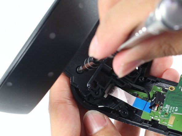

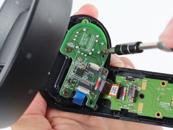

  8. Dell VRC100-R Touchpad Replacement: crwdns2935265:08crwdnd2935265:01crwdnd2935265:02crwdne2935265:0 Dell VRC100-R Touchpad Replacement: crwdns2935265:08crwdnd2935265:02crwdnd2935265:02crwdne2935265:0

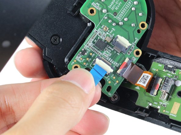

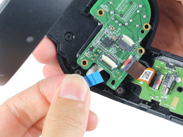

  9. Dell VRC100-R Touchpad Replacement: crwdns2935265:09crwdnd2935265:01crwdnd2935265:03crwdne2935265:0 Dell VRC100-R Touchpad Replacement: crwdns2935265:09crwdnd2935265:02crwdnd2935265:03crwdne2935265:0 Dell VRC100-R Touchpad Replacement: crwdns2935265:09crwdnd2935265:03crwdnd2935265:03crwdne2935265:0

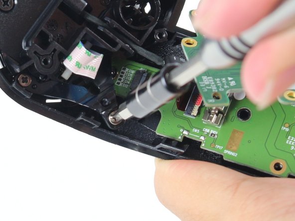

    • Use the tip of a plastic opening tool or your fingernail to gently flip-up the white locking flap.
    • Make sure to only lift the flap and not the connector socket because the socket easily breaks off.
    • Grab the blue cable and pull away from the socket.
    • To reinstall, insert the blue cable into the connector and close the flap on the black line.
  10. Dell VRC100-R Touchpad Replacement: crwdns2935265:010crwdnd2935265:01crwdnd2935265:02crwdne2935265:0 Dell VRC100-R Touchpad Replacement: crwdns2935265:010crwdnd2935265:02crwdnd2935265:02crwdne2935265:0

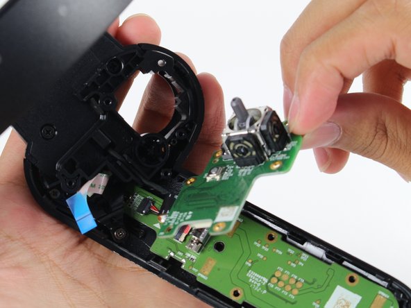

    • Place two fingers on the perimeter of the daughterboard and fold it down along the orange cable.
  11. Dell VRC100-R Touchpad Replacement: crwdns2935265:011crwdnd2935265:01crwdnd2935265:02crwdne2935265:0 Dell VRC100-R Touchpad Replacement: crwdns2935265:011crwdnd2935265:02crwdnd2935265:02crwdne2935265:0
    • Remove two black 6mm Phillips #0 screws.
  12. Dell VRC100-R Touchpad Replacement: crwdns2935265:012crwdnd2935265:01crwdnd2935265:02crwdne2935265:0 Dell VRC100-R Touchpad Replacement: crwdns2935265:012crwdnd2935265:02crwdnd2935265:02crwdne2935265:0

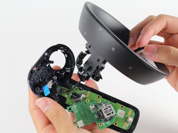

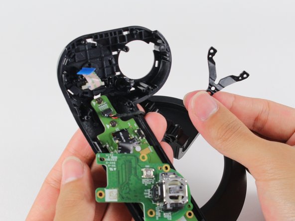

    • Pinch the black ring on the top of your controller and pull toward yourself to disconnect it.
  13. Dell VRC100-R Touchpad Replacement: crwdns2935265:013crwdnd2935265:01crwdnd2935265:02crwdne2935265:0 Dell VRC100-R Touchpad Replacement: crwdns2935265:013crwdnd2935265:02crwdnd2935265:02crwdne2935265:0
    • Remove three 3mm Phillips #0 screws.
  14. Dell VRC100-R Touchpad Replacement: crwdns2935265:014crwdnd2935265:01crwdnd2935265:02crwdne2935265:0 Dell VRC100-R Touchpad Replacement: crwdns2935265:014crwdnd2935265:02crwdnd2935265:02crwdne2935265:0
    • Insert your finger underneath the black plastic "V" and scoop up to remove it.

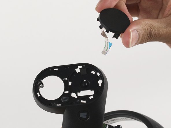

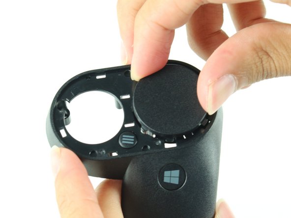

  15. Dell VRC100-R Touchpad Replacement: crwdns2935265:015crwdnd2935265:01crwdnd2935265:03crwdne2935265:0 Dell VRC100-R Touchpad Replacement: crwdns2935265:015crwdnd2935265:02crwdnd2935265:03crwdne2935265:0 Dell VRC100-R Touchpad Replacement: crwdns2935265:015crwdnd2935265:03crwdnd2935265:03crwdne2935265:0
    • Place your thumb on the outer edge of the touchpad on the other side of the controller.
    • Push toward the center of the circle to get your fingernail underneath the touchpad then scoop away from yourself.
    • You can see the detachable black flaps underneath the touchpad along the perimeter.
    • Turn your controller over and remove the touchpad.
